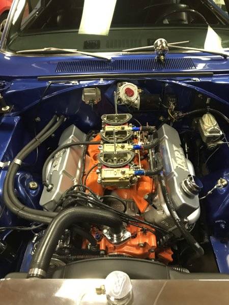

Side hung float bowls, not the cathedral bowls. They are shorter. @Sonny .
No Bob, two barrels and four barrels are rated at different depressions. Don't quote me, but two bbls at 3", four bbls at 1.5"
You need the DC holleys.....
Spoke to Holley tech and they confirmed it would.I dont know for sure, thats why i suggested a carb guru. It looks right to me, its primary side so it has an accelerator pump provision. You would probably be able to use the pump and needle and seat from the cathedral bowl, but you would obviously need the side hung float and linkages.

Curious...... are the fuel level sight plugs on those side hung outboard bowls lower than the center carb like the six pack center hung bowls?

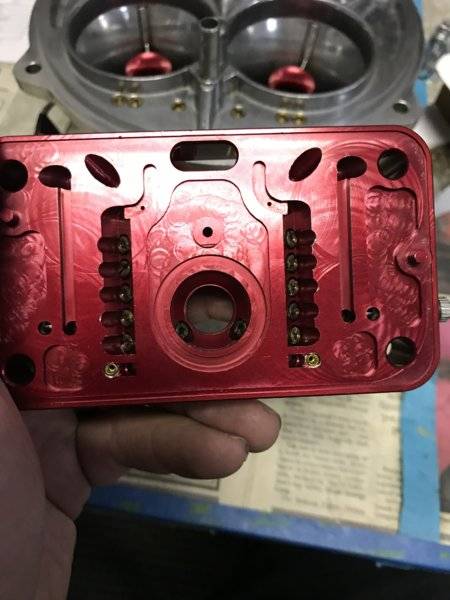

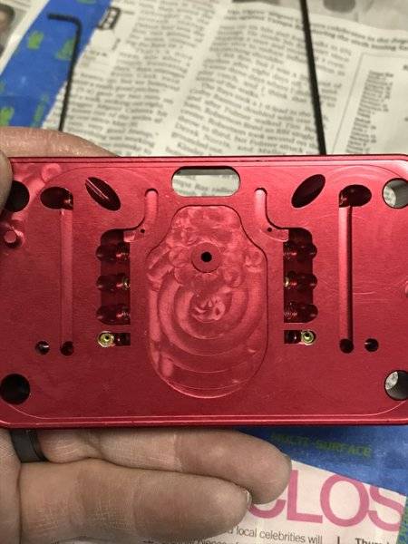

@68 HEMI GTS , are those qft metering blocks? I just bought a qft primary block for an ancient 850 dp, hoping to get some adjustment. If they are qft, how do you like them?

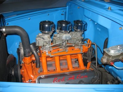

Re: Rochester vs Holley 2bbl carbs per this thread, my experience was the Rochesters leak fuel, often, on many people's cars, to a point where more than one Pontiac Tripower owner said "yeah, they all leak like that"...
Well that wasn't acceptable to me, and now our Tripower on the 421 in the 65 GTO is pristine, and does not leak fuel, anywhere. They have also had internal modifications done, like drilling and component parts swaps, to bring their performance up to the performance enhancements of the 421.
