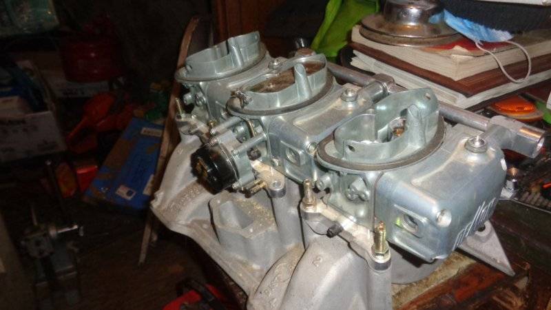

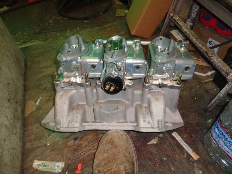

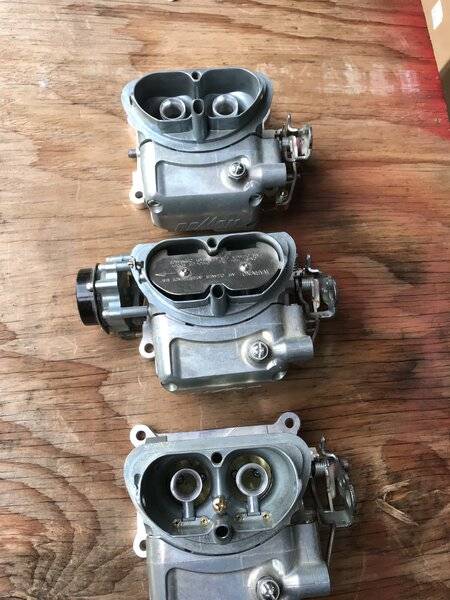

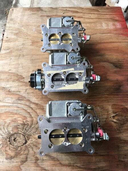

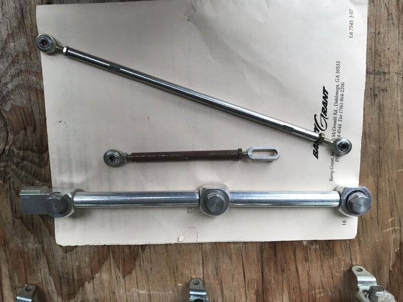

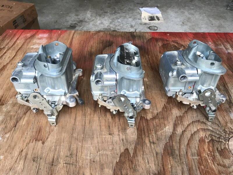

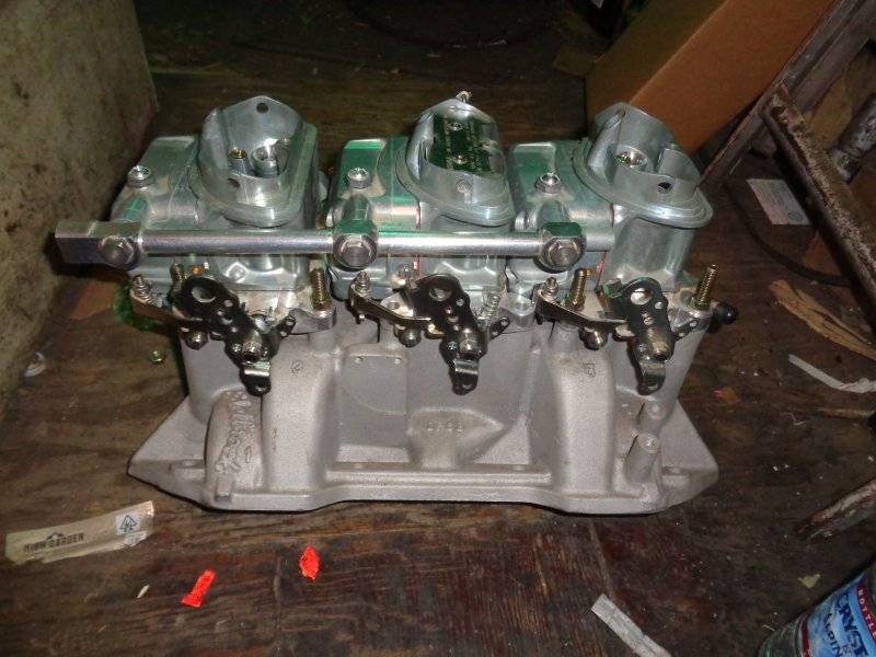

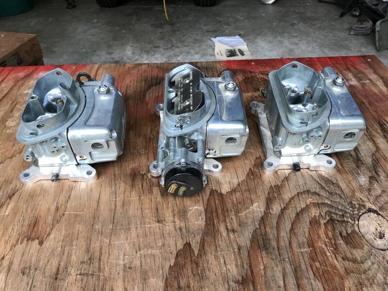

i just bought a barry grant six shooter setup for my driver 383 , these carbs are only 250 cfm each . should offer up good fuel mileage and good throttle response . its for my wifes cool driver . it will go into her 65 bel rag i bought her . she doesn't know about the buy . plan on surprising her with it . i've been hinting around about color and car nick names . but i have so much stuff going on . i still think it will be a surprise . what do you guys think , anyone used them ?
View attachment 976225 View attachment 976226 View attachment 976228 View attachment 976229
How do I get that fuel log!!!
it was part of the barry grant setup stuff .

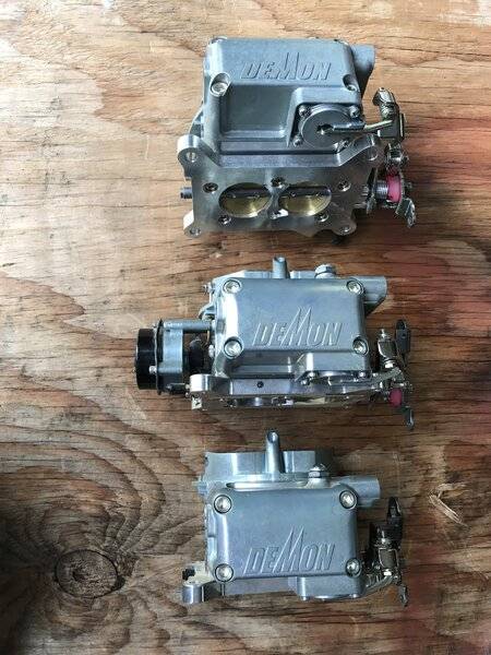

I was...was really excited when I was doing deep dives on "6 pak" research a couple of years ago and as an ongoing exercise, when I found the Demon/Barry Grant setups...
THEN

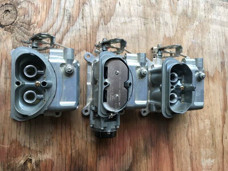

I found out how much LESS, a LOT LESS air and fuel they flowed vs the factory Holley 2bbl carbs. They are on a par with the Pontiac Tripower Rochester 2bbl carbs though, at around 790 total CFM.
There are actually a lot of adapter plates sold to convert the Pontiac or Chevy Tripower intakes from 3 'Chesters to 3 Holley 2bbl carbs!
