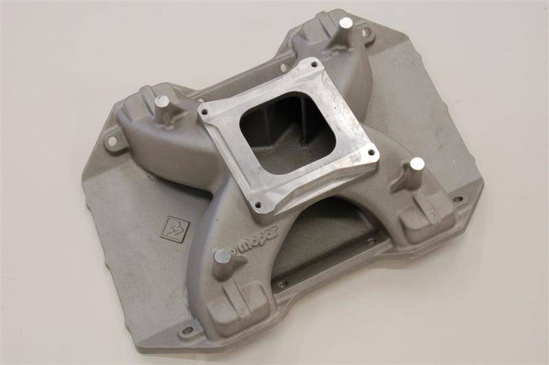

Larry Smith did mine. (Flow Tech 2)
This was before the 270s came out, he opened them up to MW size, and matched my 337 intake to MW size as well.
The ports were almost a mirror finish, really pretty,
I can't remember, either 360 or 370 cfm @ 700
His price was almost half of any other quote I received.

What are you using for valley pan gaskets since you opened them up to max wedge size? I was using andy f's ar engineering valley pan and "bat wings" when my 240s were standard size, just wondering what combo you used for valley pan and intake gaskets. Thanks in advance
The 337 manifold has a built in valley plate.
I used Superformance gaskets (good stuff right there).
