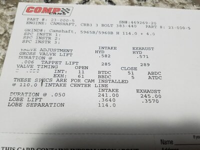

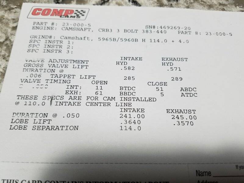

The lifts shown on the cam card are for using 1.6 rockers.
It’s not over .600 lift.
Lobe lift x RR = valve lift.

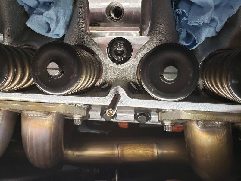

I'm pretty sure you're not interested in PRW stainless, but here is my sweep (post cam "break-in"). 1.6 ratio (cup style adjusters, per Mike's (B3RE) recommendation), TF240's, Ultradyne SFT, B3 correction kit.
The adjusters did feel "gritty" upon arrival. Disassembled them, cleaned them thoroughly, soaked them in oil overnight. 2k miles so far, no issues. No problems setting side clearance during assembly.
Re-ran valve adjustment at 1500 miles, only minor adjustments needed.

Your cam card shows "lobe lift" of .3640. That's the lift capability of the cam lobe itself.
They then show "gross valve lift" of .582.
Divide .582 by .3640, you get 1.6 (technically 1.59xxx but close enough) which is the rocker ratio they used for the specs.
So with a 1.5 rocker your theoretical lift is .546. It's "theoretical" because you lose a few thousandths due to pushrod/rocker deflection, angularity etc.
I'm pretty sure you're not interested in PRW stainless, but here is my sweep (post cam "break-in"). 1.6 ratio, TF240's, Ultradyne SFT, B3 correction kit.
