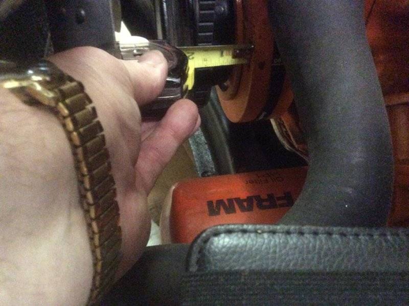

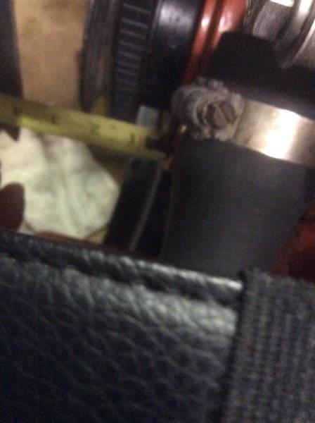

I have a 2 groove pulley but the outer groove only is for power steering. The groove closest damper is the same distance as a single groove pulley. Should be able to measure tomorrow will try to do pictures.
Pictures are lousy. Put tab of tape measure against front of damper and these are the measurements without allowing tape measure tab.
Damper to back edge of pulley 1.125" damper to front of back groove 1.626". The angle of the camera distorts the measurements so don't go by pictures. Pictures are more to show you how I measured.
