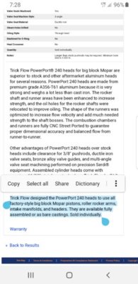

WRONG
I have Crane 1.6 rockers and had to get custom pushrods from Manton. Did the fitup and lined it all up and engine ran well
What did your pushrod length end up?
Also see you have to use a stud kit too
The key word in the trick flow literature is “style”. :thumbsup:
Says the heads work with factory “style” hardware, which is accurate.
There is no way trick flow can know what size pushrods you’ll end up needing.
