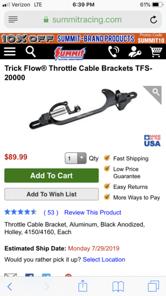

Who's got the best idea on the kickdown linkage and throttle cable extension for the trickflow head and intake?
The Trick Flow intake is tall so you'll need a tall throttle bracket and you'll have to convert over to a cable type kickdown. You'll also need a tall throttle return setup. Hughes Engines or Mancini Racing will have everything you need.

Andy I got your AR005 and AR 119 from hughes , Mancini said AR didn't make anything, which I knew wasn't true,
Can you recommend a cable for the kickdown? Also will I need a longer throttle cable if so you got either?
I've used the Lokar cable in the past for kickdown. I'm not impressed with the quality of the Lokar stuff but it seems to work. Mancini Racing has longer throttle cables. Most of the time the old slant six cable works but you can also use a tape measure to figure out how long of a cable you need and order the one that is closest in length.
