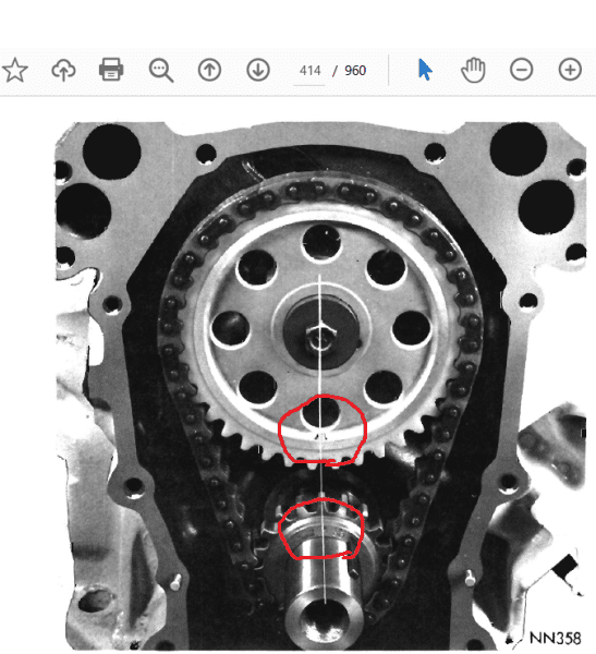

Speaking of which, here ya go, right out of the FSM:
A good service manual is worth its' weight in gold - and they're still available for reference online, too. :thumbsup:

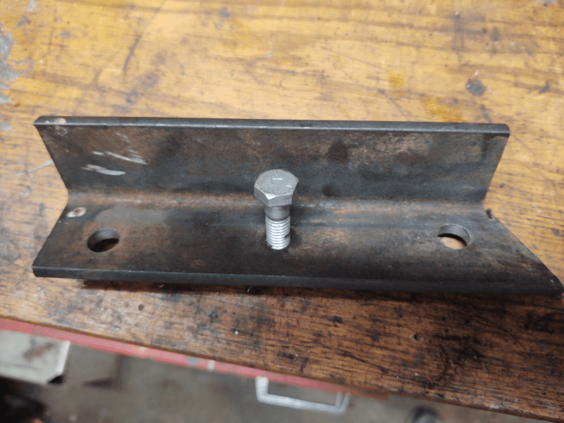

I guess at this point before you install heads my suggestion would be to at least find how accurate your TDC mark on your balancer is at.
You'll need to make or obtain a piston stop above cylinder #1 and then rotate the crank each direction until it hits the stop.
Write down the two numbers on the timing indicator when the piston hits the stop.
For example -8 and +7 degrees, add and divide by 2 so then your real TDC would be (-8 + 7)/2 = -.5 degrees.
It's an easy thing to do and then you know exactly what your ignition timing number is.
Something like this works it doesn't have to be fancy:

Ok fellas, here's where Harry starts wondering "is it worth the aggravation and confusion to degree this cam?"
I bought this
and this
Because neither were in the Trick Flow branded degree wheel kit I purchased.
When I use the TDC "bar" tool, the piston does not stop, I have to adjust the small stud/pin in the center.
So I would only be stopping against the pin (assuming I set the depth correctly)?
There's no defined stop, it's variable, I'm playing with that stud/pin.
I'm having trouble getting past how I am measuring degrees on a wheel but to start I am going off something sooo variable.
I could dot to dot and then adjust the tool to stop the piston, but then I lost where it "truly" is when at TDC.
I watch YT videos and the ******* piston stops.
