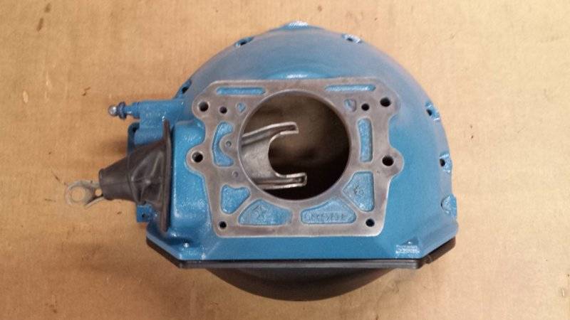

Looks like a member here is selling the proper bell housing and fork.

I have this bell housing for sale. Might have the motor mounts, oil pan, e-manifolds and water pump housing.
Both SB and BB housing take the 143 tooth flywheel and same clutch. Only difference might the balance of the fly wheel depending on which BB motor you use.
