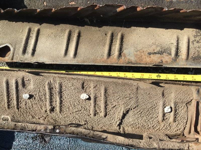

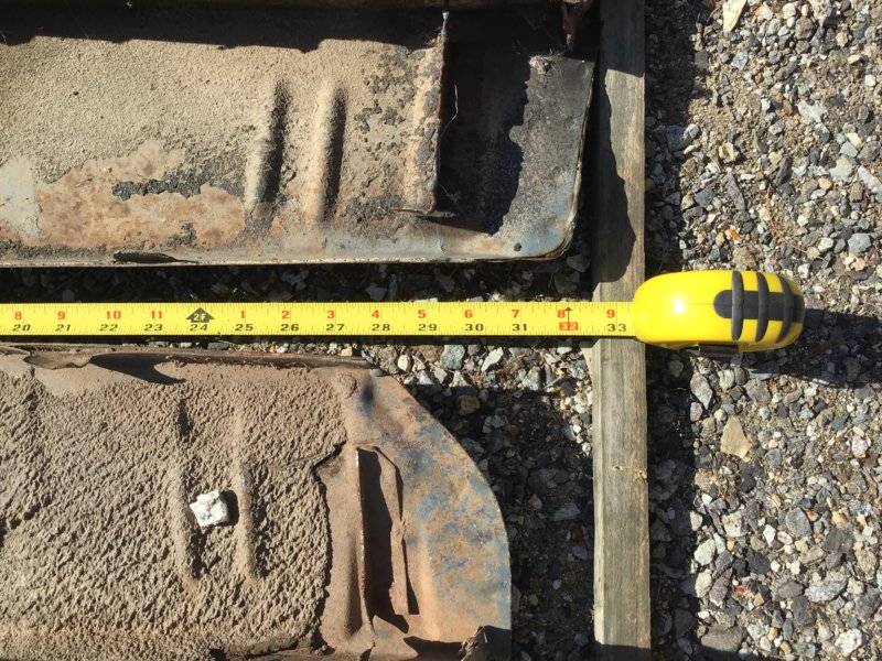

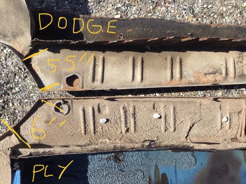

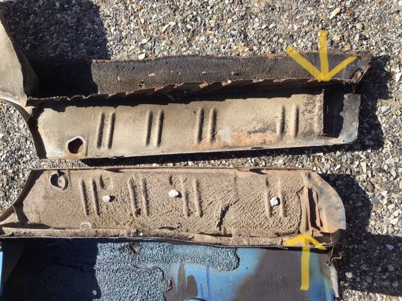

Here is photo evidence they are different. Top is 67 coronet, bottom is 67 Belvedere. I lined up the front and Look at the overall length difference. Look at the yellow areas where the panel behind the bumper goes. Look at the 3 whitish rocks I put on the bottom panel, above them there are squares stamped into the Plymouth part, and they are absent on the Dodge.
On a 2 door 1967 from door jamb to end of quarter panel (not the extension) a Plymouth is 85 11/16” long And a Dodge is 89 7/16”
I got a nice coronet trunk mat and had to cut it shorter to fit in a Plymouth trunk.

No they were easy to get out of the shed. I knew they were different, glad to share the photos. It looks like Plymouth might be cut shorter, but the 3 squares and the different length up front makes the difference.
I’m unsure why the parts book said they were the same.
YES glad I have them to take photos of! LOL
At first I’m was thinking they could cut the ends off of the extensions to match the quarter skins that goes on them Dodge or Plymouth. But the front measurements are different and this 3 stamped squares, possibly as a quick identifier for the metal shop just by looking at them.
