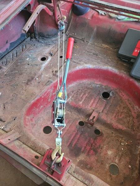

C.moo, did you figure out how to put your trunk lid springs on without knocking one or more of your fingers off ?? I just added one more hole of tension to my 64, took about ten minutes to do, once a procedure is establested it goes pretty quick. I use a 16 inch round pry bar and a 500 lb come along from mcmaster-carr. the come along will fit in one hand chain and all!! hook to the latch loop in the center of the trunk and run the other end to the torison bar loop, then use the come along to bring it to where you can get it started in the hole with the little pry bar. ease off the comealong and guide it in. Dave.

After a couple smashed fingers, I searched and found this post. Worked out great for me! 20230212_153530.jpg
