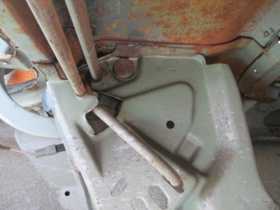

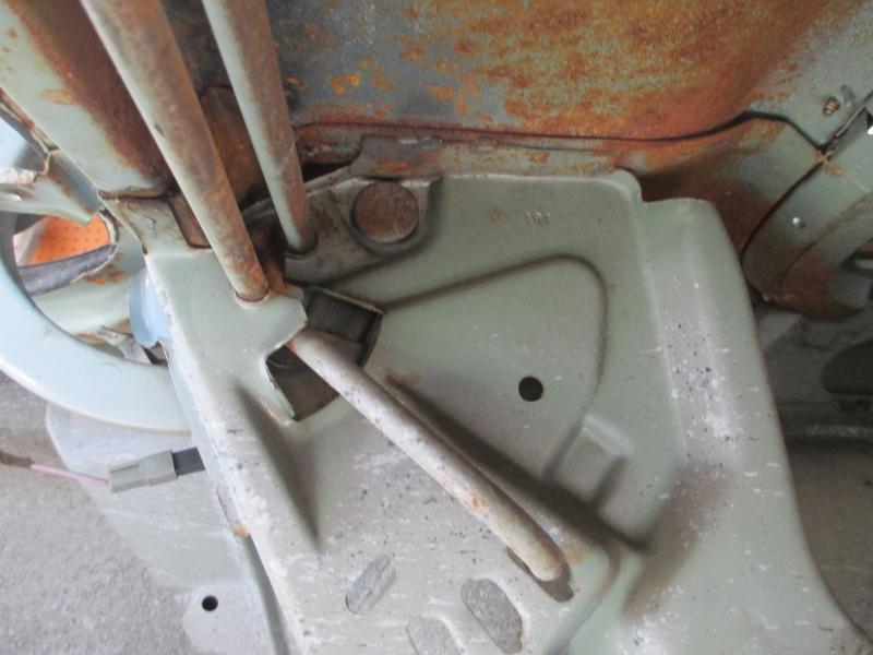

Are 5-22-15 029.jpg5-22-15 031.jpg Are these helpful? It's a 66 Belvedere I.

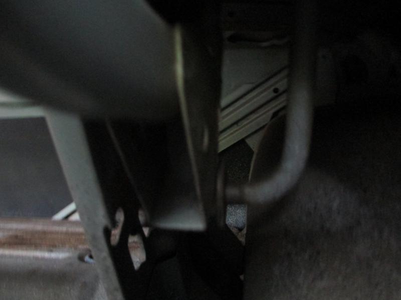

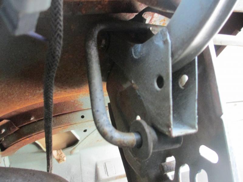

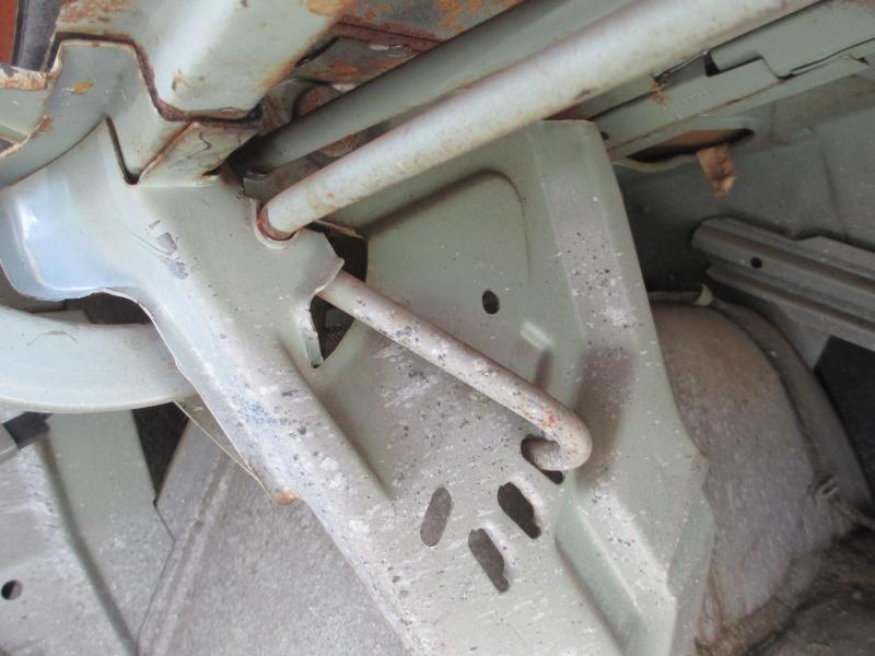

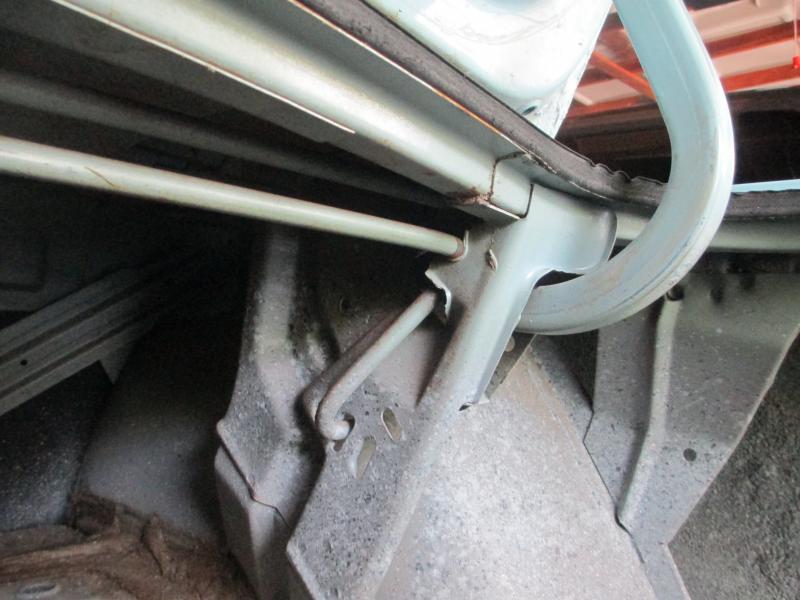

These are of the drivers side. There is an upper and lower bar. The upper has "c" shaped ends and the lower has "z" shaped ends. Hope these are clearer. If there wasn't a fuel cell in the way I'd lay in there and get better shots.
Thanks Claw.....that will give me a lot more perspective of what I'm attempting to accomplish. Now if the rain would just quit here in Texas for a couple of days, I can then try these springs out. Also, I see on one of your pics, you have a round roller that fit's over the "c" end. Well, obviously I am needing these before I begin. Do you have any earthly idea where I can get these? I have searched hi & low, but no hits so far.

That roller seems to be hard plastic with a metal washer on the end. It doesn't roll or move, the bar just spins inside it if that helps. No idea where to find those but if I come across anything I will let you know.
