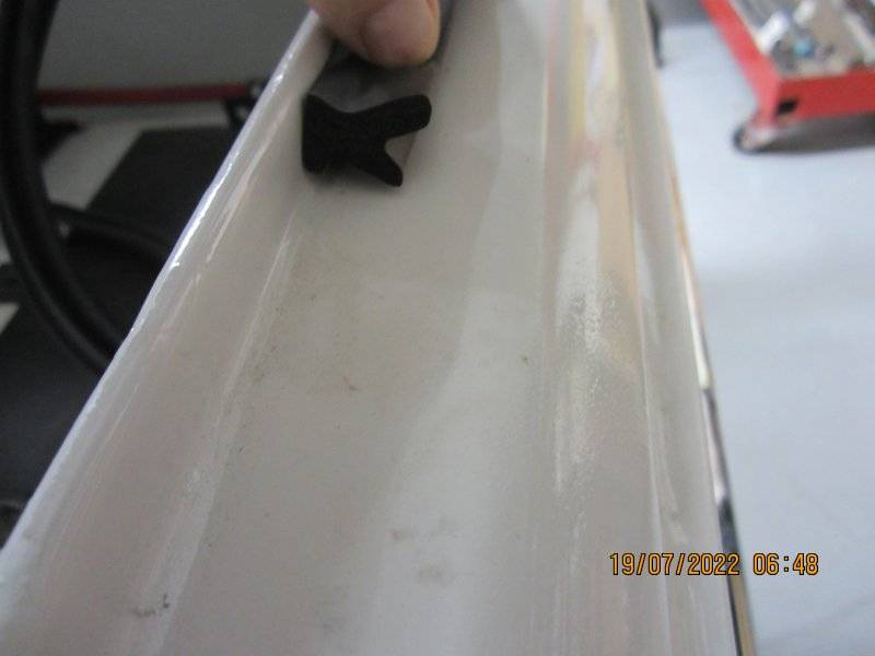

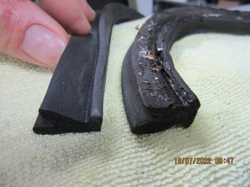

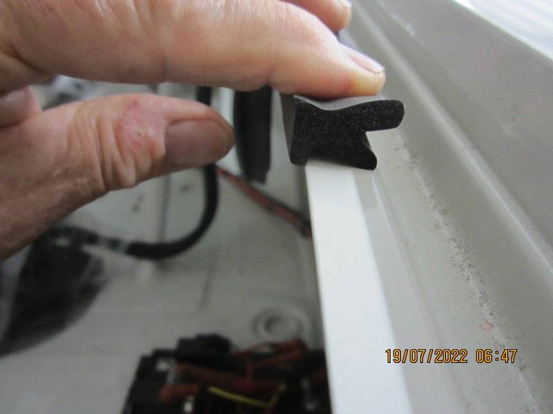

First, I had a hard time finding new rubber that matched the original. I finally found it at Chesters. Its sold by the foot, so I bought a piece that was extra long. That black 3M glue takes to long to dry. You have to use clips to hold it in place until it drys. I got Wurth glue, especially made for weartherstripping. It is suppose to dry-stick within a few seconds, so once it sticks, that's it !! I'm going to test fit a short 2" piece to see how it actually works. Along the lower back (Img 1038) the trunk surface is flat, but the seal has thet lip on the bottom side so I'm not sure how well this will lay down. I need to look thru my junk seals and see how it was fit. The seam is at the center of the back. So I'll start at the top center and work around to the right side, then the left side so they'll meet at the bottom center.
That black 3M weatherstrip doesn't really take that long to dry. You glue the painted surface, and you glue the rubber. You don't lay down the rubber seal with wet glue, it doesn't work that way. Wait until it's dry to the touch before sticking the rubber onto the trunk lip. It bonds almost instantly so be sure to carefully align it before sticking it down. No clamps needed with mine, it was stuck on as soon as I pressed it together. From the first application of glue to the final trimming and lining up of the two ends, the job was done in under ten minutes. I did this yesterday.
