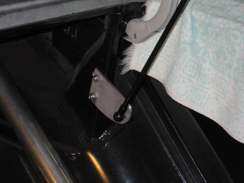

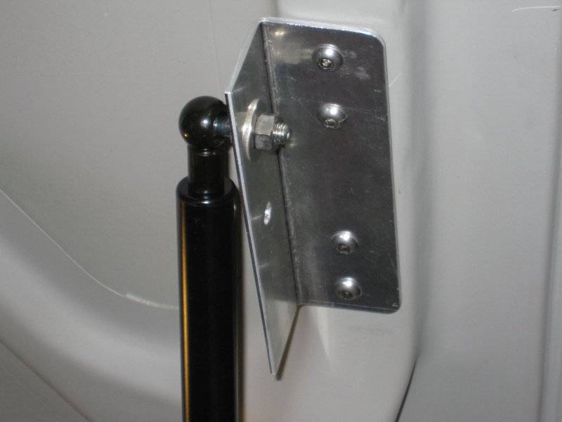

I did:
Mike
What weight rating (for the gas struts) did you use? I either have to find a set of torsion springs or go with gas struts, and from what I've heard installing the torsion springs can be a hazardous job.
I worked with NAPA to find the correct capacity struts for my situation. Unless you had identical weight and leverage conditions to me you would need something different. I went thru 3 different models before finding the correct ones. I would start at 100#. Check out my thumb. I swore I was in the clear!
