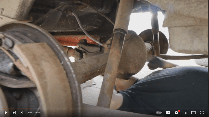

I found a picture of the glass pack he has on that very car. Its just a thrush glass pack.
Looks like this one.
Judging by the rear end, it is a single exhaust. Dual glasspacks might be a little annoying if you want mellow.
