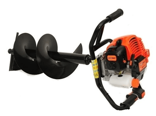

Too lazy to dig around my garage to show what I bought about 2 years ago after hiring the same type a couple of times....
https://www.trademe.co.nz/building-...tm?rsqid=110cd19eac1a4f3fa30b1bd1f06e2852-001

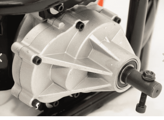

Big block - 62cc of two-stroke power...works extremely well....one man operation, I have used it more than enough to cover the hire costs had I not bought it. Paid for itself after the second job. I'm no professional fencer...but I have done small retainer walls, repaired a heap of my boundary fences, and built small walls in my garden using this machine.

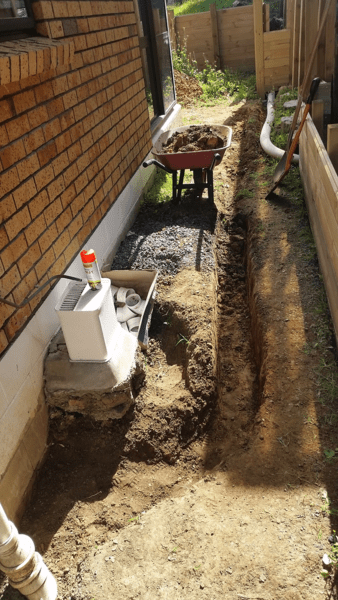

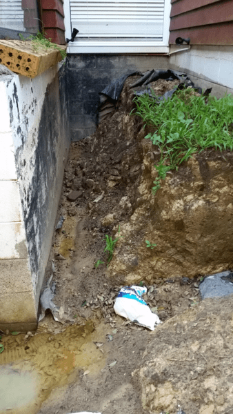

I intend to use it to plants shrubs eventually and sink the posts for a future deck. I also used it for about 10 hours worth of trenching, and cutting a bank away. Rather than hack away with a spade....I drilled a series of holes where I needed the trench (about 18" deep....then cut the edges, and scooped out the spoil...saved me a heap of digging and no blisters. I also used it the same way to cut away a bank infill at my house....drilled down in sections to loosen the bank, then scooped the spoil into my wheelbarrow. Labour intensive, but the space was too tight for a digger to get in. Saved me at least $1,000 in labour costs....and no need to hire a digger.
The shaft on mine has a quick release snap clip for attaching the augers and extension. The best tip I can give is when you are digging...don't get too ambitious with your depth. Take it slow, or you'll bury the auger. I know this from when I was an apprentice...the boss thought we could manage....every time he revved it...the darn thing just went deeper. Took a Hiab Truck to pull the damn auger out of the ground. :D

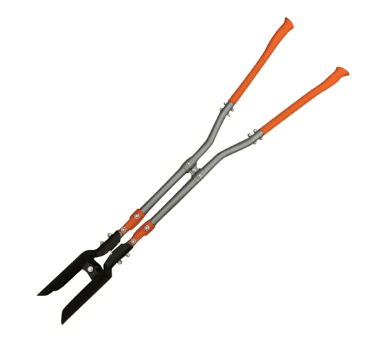

I also have a manual digger for cleaning out deeper post holes...especially after the machine we hired for our big retainer wall.....
Hard work using that one....but it is useful.

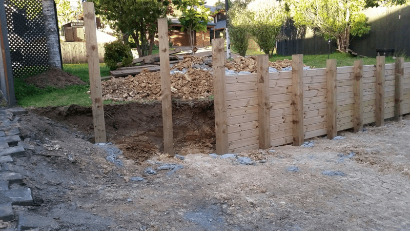

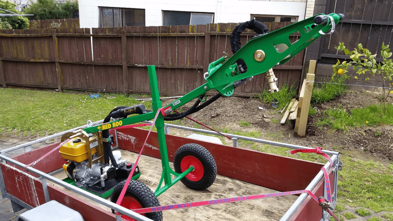

Started with hiring a counter-balance borer....difficult to use....and the space I used it was tight to the boundary, so was quite awkward...
used it on the first 7 posts in the start of my retaining wall work....

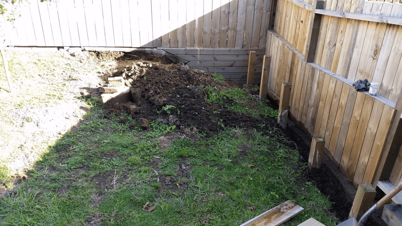

Small garden retaining walls....

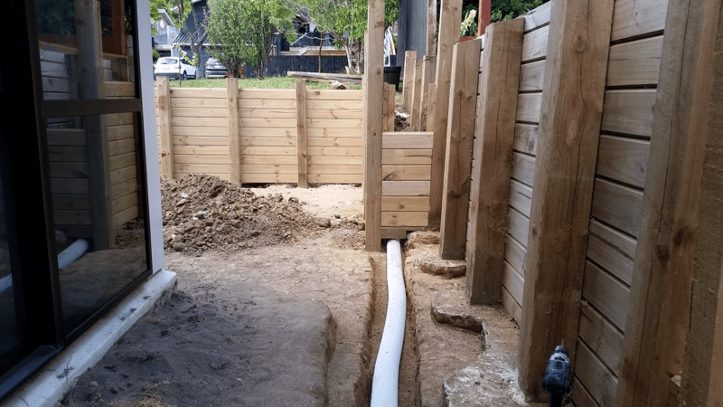

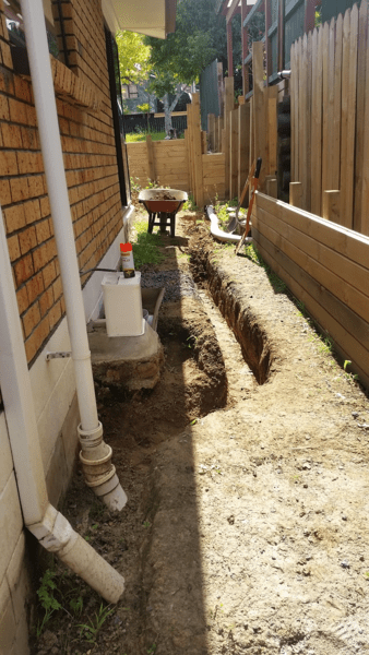

Trench work as described above....

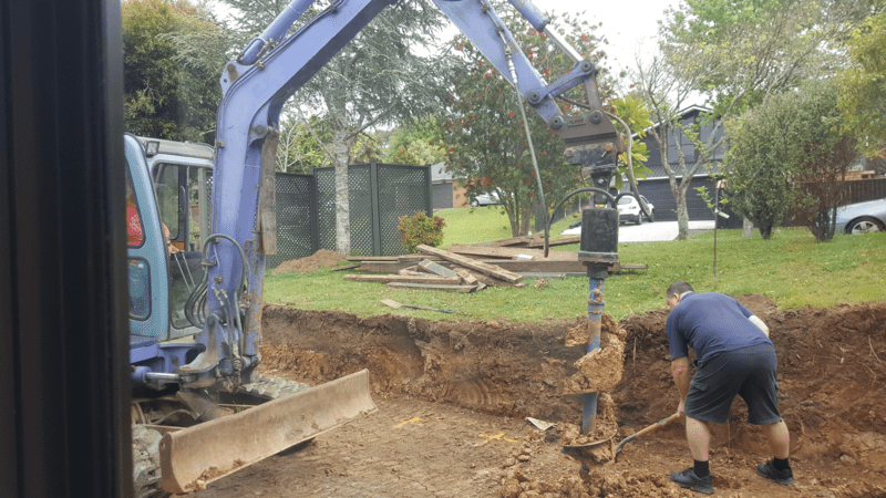

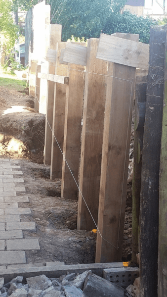

Hired a professional with a big auger for the big retaining wall...of course I was on clay removal duty

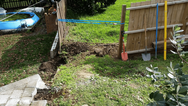

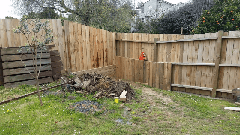

Back fence repairs....corner post is 6" x 6" to take the strain....

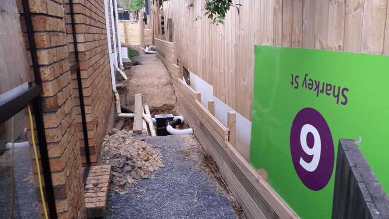

small retaining wall inside double skinned fence - to allow me to raise my lawn a bit in the corner...
And here is that alcove that I drilled with the auger and shoveled out by hand...

The method of drilling a series of holes then breaking off the areas in between...I have done that in several areas before....Demo work in construction, dirt work, cutting up a stump...

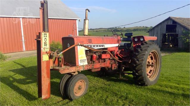

This is what I use. I am too old/lazy to throw and pack the dirt in the hole.
Those probably work better than about anything - if the wood is up to it, that is.
Seems like the store-bought pressure treated stuff ain't worth spit anymore, especially since the feds outlawed the use of some chemicals in it (like arsenic) years ago.
I've helped set many a dozen of the metal rod type fence posts using a neighbors' hi-lift, too. Sort of dangerous - hold the pole upright where you want it, bring the bucket on the hi-lift down on it and ram it on down.
Hydraulics, man, can't beat it - but things do go sideways once in a while doing
things this way, too. Gotta be up on yer toes. :)
