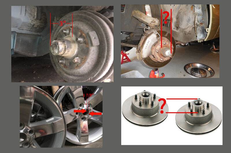

I have a set of 18" wheels from a 2016 Challenger which I would like to use on my '66 Belvedere. However, a test fit on the original drums shows that the spindle sticks out too far and won't allow them to bolt to the drum. In the photos you'll see the face of the drum to the end of the spindle and cap is 3" and the same measurement on the wheel is 1 7/8". Obviously they won't fit.
I have no problem converting the front brakes to disc. My question is on the depth, or length, of the spindle on the available conversion kits.
I've contact Summit but they could give me no information. Only that they should work with wheels designed for use on my Belvedere.
I'm not tied to these wheels, I paid $100 for all four and had to clean them up, but would like to use them if possible.
Has anyone run into this issue. Or can someone enlighten me on the depth of the spindles on conversion kits.
Thanks
Photos
Upper Left: My drum brake
Upper Right: Disc conversion photo found on the web
Lower Right: Rotor from Summit Racing kit
Lower Left: Challenger wheels

Of course they aren't going to bolt right on. The bolt circle isn't even the same. Close but not the same. Wrong hub size and offset as well.

I'm not sure of the actual measurement but this is a better visual of how much the spindle protrudes. I'll be down in my shed in a few hours and can take off a wheel and measure it exactly.

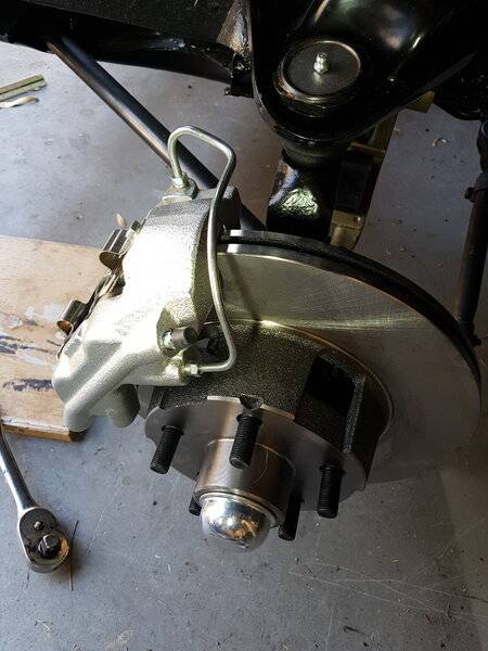

Ok I measured it - the actual dimension from the rotor body to the tip of the domed end cap is 2 1/4".

The bolt pattern on the wheel is 115 mm OR 4.52755906 inches. Yes, different enough to be dangerous. Damn metric system.

According to 66Sat the conversion hub is 2 1/4 or 3/4" shorter than my drum. But looks like this wheel idea is a bust anyway - bolt pattern. Another lesson learned.
