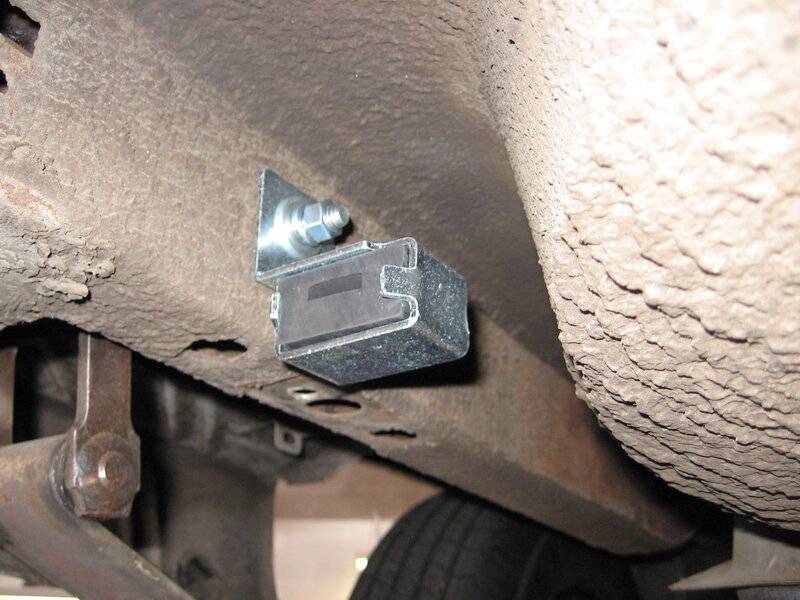

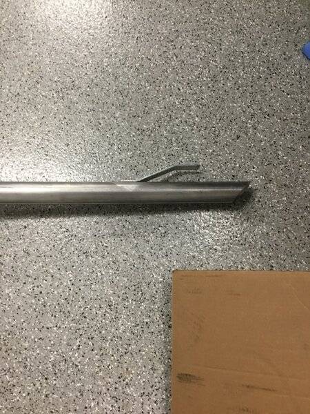

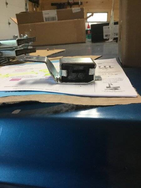

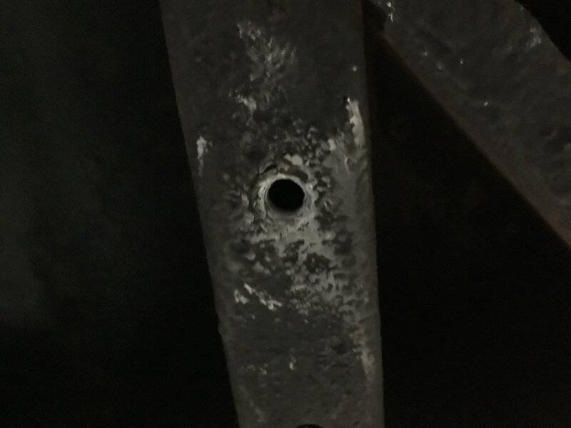

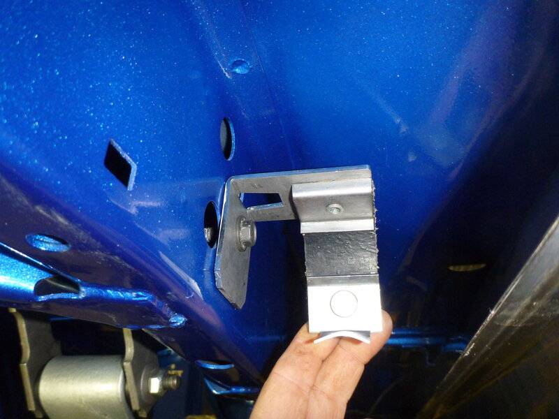

I’m installing my exhaust which is straight angle cut tail pipes from turn downs I had before. They gave me offset tail pipes brackets and to use frame rail threads. Mine are stripped. Does anyone have pictures of there tail pipes mounted.
Thanks Anthony

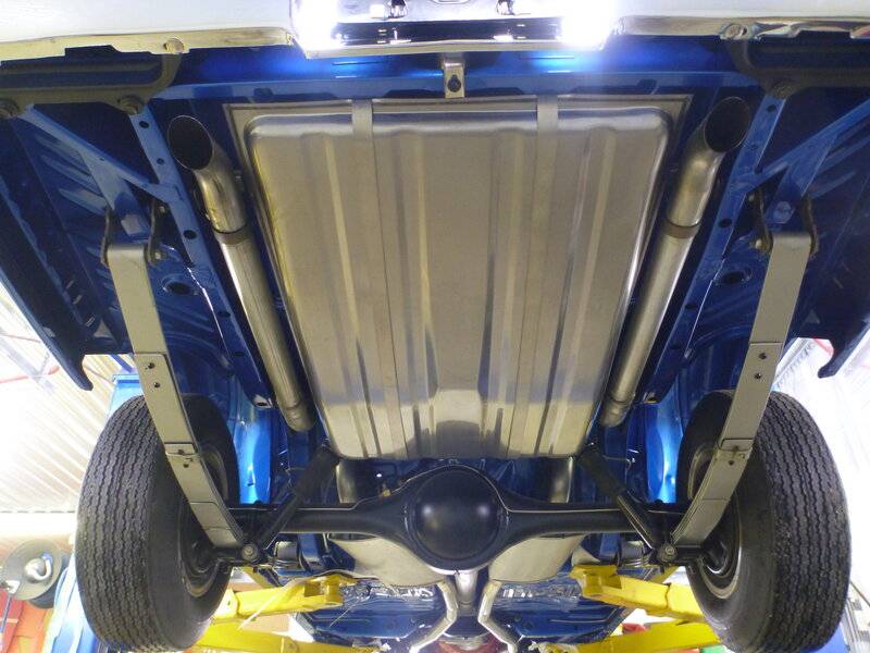

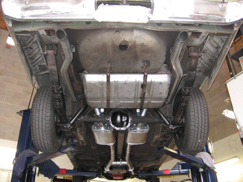

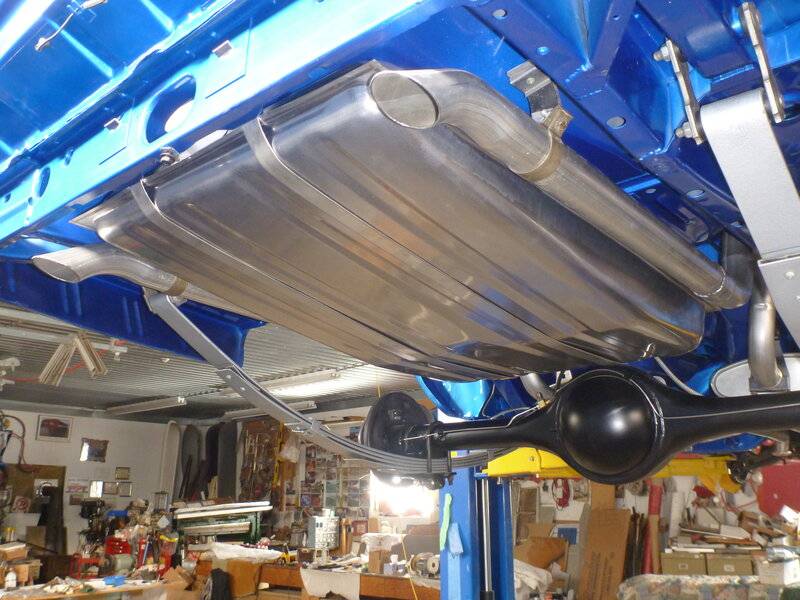

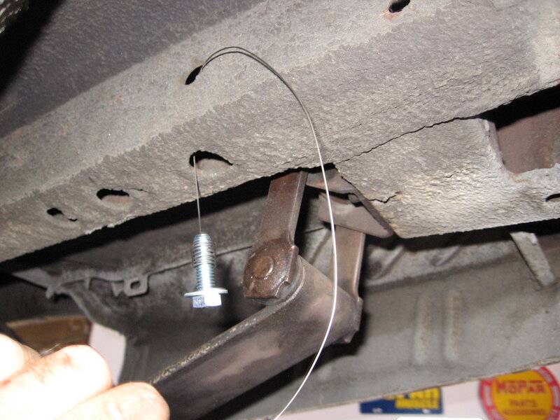

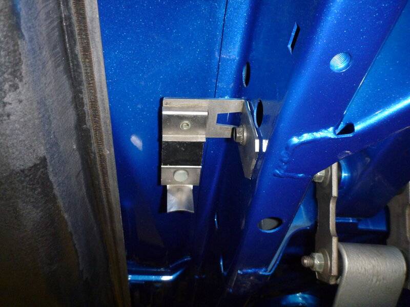

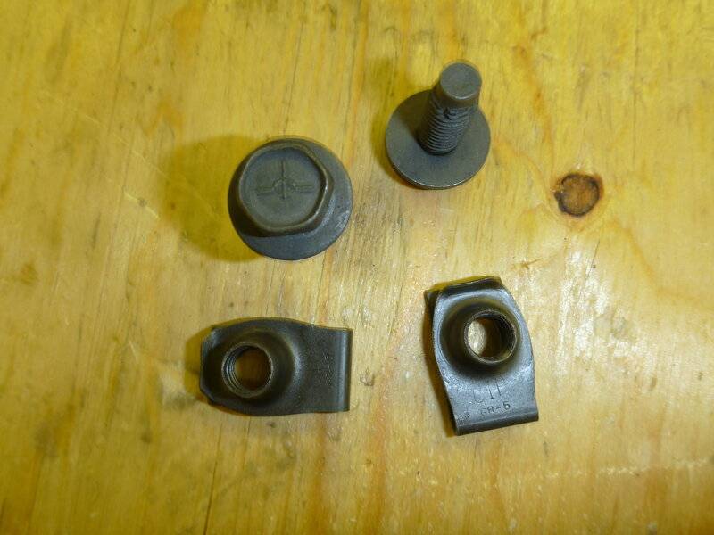

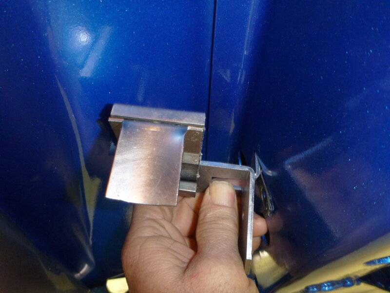

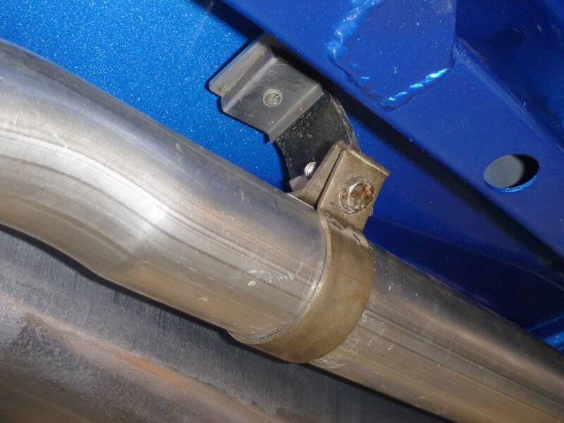

Turn down pipes use a J nut and bolt, chrome tips use the welded in nut in the bottom of the frame rail that you can clearly see in picture four.

Those hangers are designed for the tab on the chrome tip to slid into, how you going to do that if not using tips?
View attachment 962869 View attachment 962870 View attachment 962871 View attachment 962872

Is this a tti exhaust? If so what year is your car? I wanted turn downs but did not see a kit offered with that option for my 69 satellite. Ended up going with the same style as the original poster.
NO.. correct OE exhaust front to back from ECS. OP was asking about tail pipe hangers, what the pictures were for..
