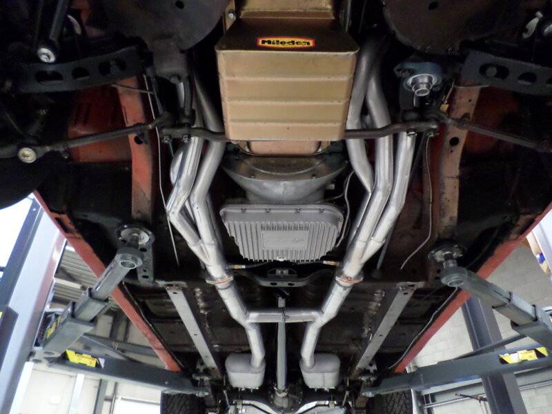

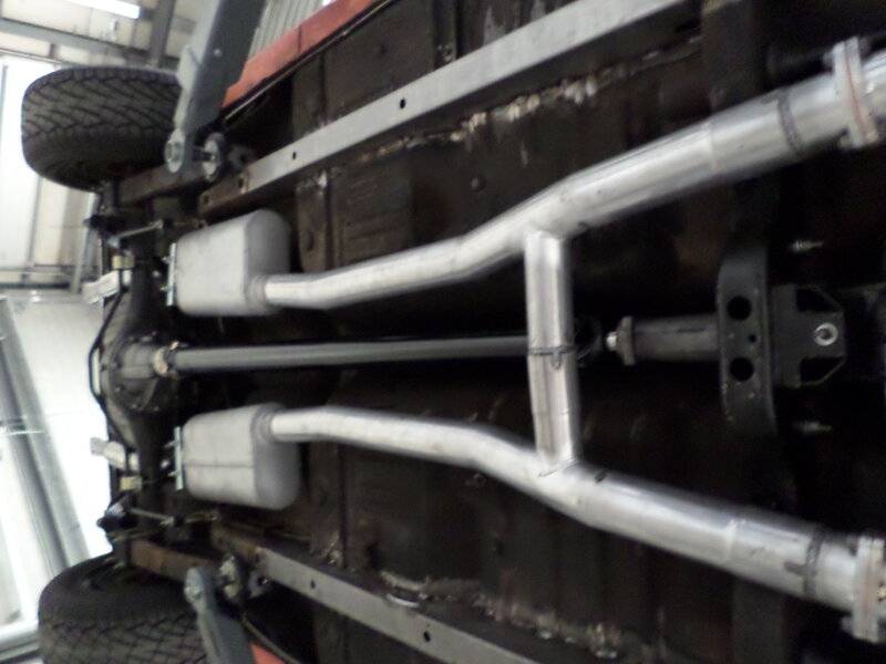

3" system on my '70 Coronet, no clearing issues. System is TTI .
The only modification we had to do is cut just before the H-pipe, to bend the pipes upward so they are close against the floor. After the muffler we welded V-band camps, so we could get the right angle to go over the rear axle. The muffler hangers are only there to support the system.
All was TIG welded. We did a lot of measuring and test fitting before welding, and it took about 8 hrs with 2 on the lift.
Will see if i have more detailed pictures.
I know the 3" tailpipe are very snug going over a Dana 60, and by the gas tank. But they do fit.

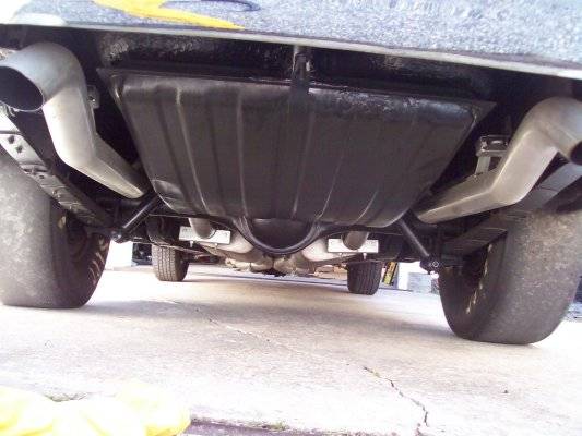

I run the TTI 3" full exhaust system on my 63 Sport Fury with the X-pipe and TTI 2" headers. Its fits my car just fine and has good room in the back as you can see. I don't think TTI would make and sell the 3" system if it would not fit but of course it may be tight. I also run Dyno-Max Ultra-Flow mufflers and its not that loud at all when at idle or cruising. Its a bit loud only when I lay into it but with my tailpipes all the way out the back it helps keep the noise down. My eng makes around 600 hp and it pushes my 63 in the 10's through this full exhaust as I race it just as I drive it. Myself I like the 3" X-pipe system because its not to loud for me and it still runs good when racing through the exhaust. Ron
