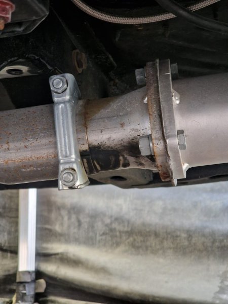

Hey all, just consulting with the hive mind before I reassemble my exhaust system after pulling it to weld o2 sensor bungs and install my Borgeson power steering box. While they were off the car, I took the opportunity to prime, paint and clear coat them with VHT Flame proof paint.
Firstly, I have the TTI headers, 2.5" exhaust system with X pipe, and Borla Atak mufflers. I fitted the system a couple of years back (long term resto project) using the U clamps provided by TTI, and following the instructions, worked from rear to front. The system went together pretty easily with no real concern regarding fitment or interference.
Since installation, I have started the car a number of times, mostly to tune and time the engine but have yet to actually drive the thing. As it's a mild steel exhaust, however, and with the UK being a combination of cold, wet, and damp in the winter, and less cold, wet, and damp in the summer, corrosion has started on the surface, so in the interest of logevity, decided some paint would help last. Whilst under the car, I noticed that most joins have soot marks from gas blowby indicating pretty significant leaks at each join. I figured that maybe I hadn't tightened the clamps enough, but that doesn't appear to be the case as I aped on the nuts when doing them up originally. My only guess is that they weren't pushed in far enough?
I am swapping the U bolt clamps out for slip on style clamps but I'm curious what the consensus is regarding using A SMALL AMOUNT of exhaust putty/assembly paste? I intend to drag race the car, so it's not beyond reasoning that the exhaust system is going to be on and off more than a few times so I'm looking for advice and opinions from people who have had experience with this issue and what your workaround was.

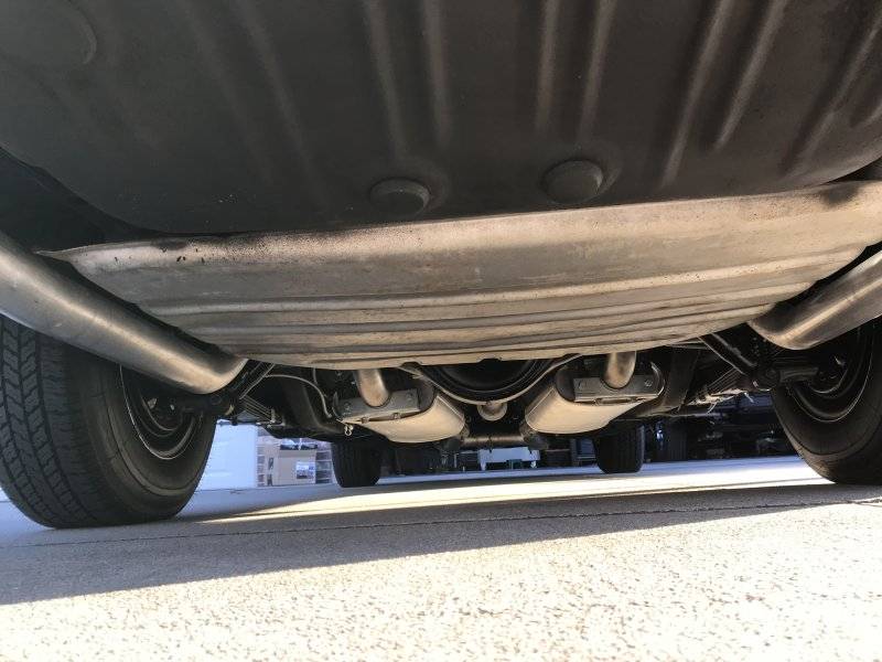

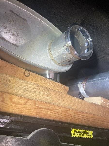

As you can see by the witness mark in the photo here, it looks like the exhaust only slipped into the muffler by about half an inch. Other joins that had significantly more inserted pipe into the joins were also leaking

I would definitely use the band clamps and they will also make future disassembly easier than compressive u-strap clamps. They will probably take care of your problems even if you don’t have full engagement of the slip joints. Where were the connections with little engagement - at the front of the mufflers? If so you muffler may just have been positioned to far rearward. Or the header connections need to be repositioned. A little muffler putty won’t hurt but the band clamps may take care of the issue alone.

The 1/2" engagement areas are not going to work, they need more
If you would drive the car it would fall into place and not leak. The vibration and heat will seal it up.

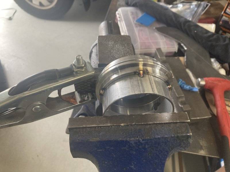

In case anyone asks, I did fully weld the flanges. They are just tacked in the pictures for fittment checking.

Yeah, I was bit upset about that, especially as I paid out so much for them. That and beating the sh*t out of the ceramic coating on the headers that I paid extra for when removing and refitting the headers multiple times when chasing a bad starting issue, gave me the incentive to repaint. I'll look into the position of the mufflers as you are correct, the front muffler connections are the worst offenders.

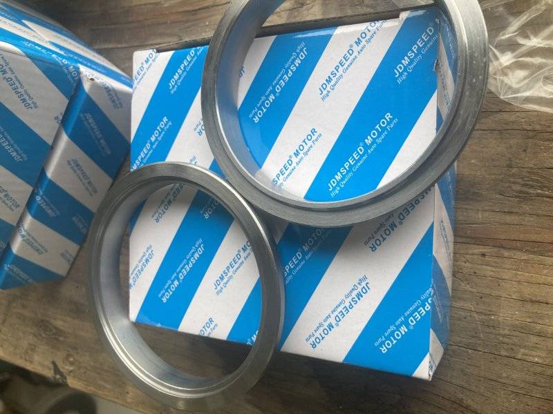

I've managed to source some pretty decent looking connectors that aren't premium grade Chinesium and will fit my 2.5". Definitely going to weld the collector to the x pipe though as its so short. I can only be a good thing getting rid of one pair of joins in the system
Something doesn't seem quite right with the pipes being too short. I have installed several sets of TTI exhaust kits with headers and never had that issue. I wonder if you didn't get sent the wrong kit for your car?

It's more like operator error and me having the mufflers in the wrong place. I've checked the part numbers and they match up. With the exhaust system off the car at the moment, I'll take a bit more care refitting it, and hopefully the band clamps will help with the seal
