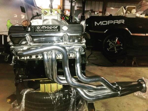

I found fitting them in my small block A body a little bit of a pin but pretty good in the way the fit and sit in the cars engine bay. I did have to give a tube a small dent at the manual steering boxes to inside corner. Not a big deal at all. The #7 slip on around the T-bar was tricky and a little hard. Once everything was in, I now have an idea how things work and slide in. The next time, it’ll be a snap.

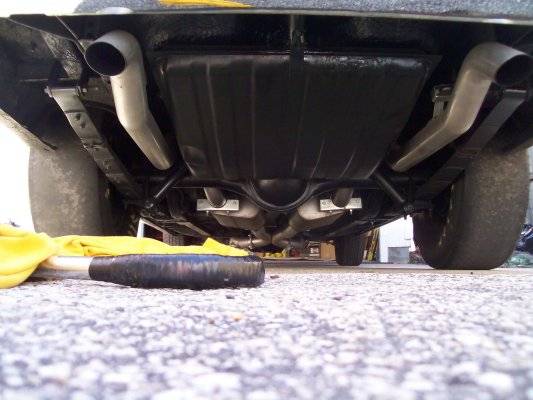

Oh! I also ordered there 2-1/2 X pipe exhaust. Start at the rear, work forward. The pipes that connect the mufflers to the X pipe needed to be shortened. The exhaust systems they make are probably all the same between the headers and mufflers with tail pipes being for the body line.
If your going to wonder what I think or feel, then I’ll say it like this.
“I look forward to purchasing and installing more of there exhaust systems. In full or part but suggest in full.”

They are nice...they're still headers though..don't expect it to be too easy. Mine needed only one small dimple over the steering link, the hookers I had previously weren't really harder to install, they just fit like crap and needed lotsa beatin'..

Little ding will do ya on the passenger side idler. 100 degree cooler underhood temps than anyone else with these. It hurts to dig deep in the wallet, but worth it in the long run.
In both my B-body big block cars they fit nice. Both cars are close at the drivers side transmission cross member though. Just had to make sure the motor was pushed to the right as far as it will go. On my small block Duster there was a bit more hassle though. Had to modify my z-bar and dent #7 tube to clear the torsion bar. As mentioned above, make sure your motor mounts are new or close to it.
