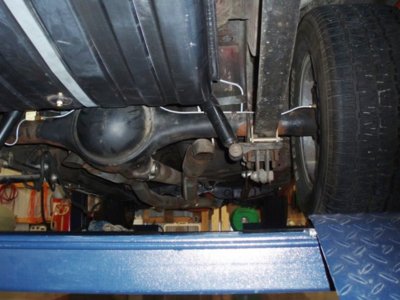

My 62 Belvedere with springs relocated to main uni-body sub frames and stock wheel wells. Plenty of room for more tire inboard. Running 275/60-15 on 10" rims.
