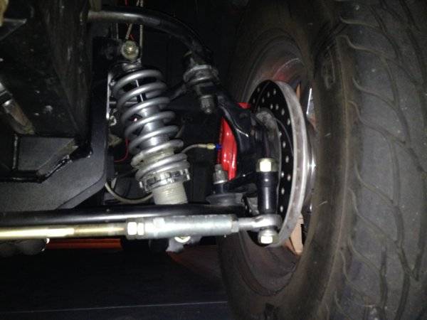

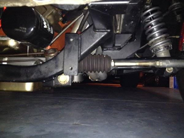

I have Hedman 3" long tube headers and I can't say that I notice a whole lot more clearance with the new K frame vs. the old one. I bought the QA1 piece because my original K frame was pretty mangled, and for the price it was only a little bit more to get a brand new one (free shipping) vs. buying a used one with unknown history plus the cost of shipping.
I'm a happy customer. Zero downsides so far.

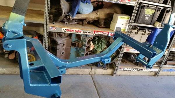

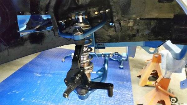

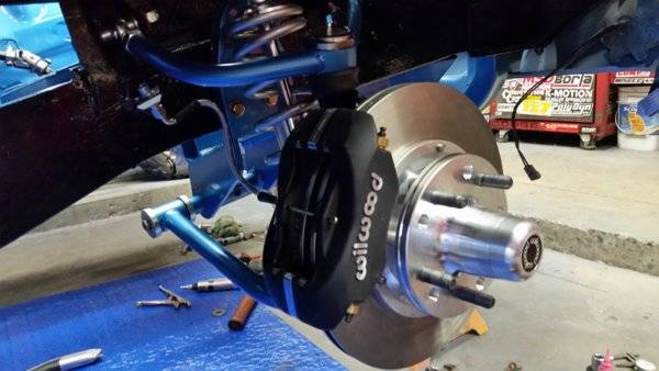

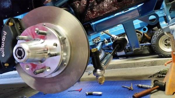

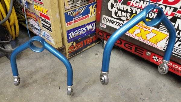

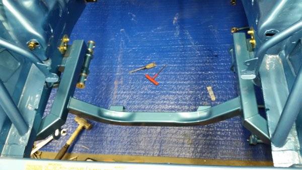

Gerst is almost identical to RMS except he use's some 1/4" plate and some 3/16 instead of all 3/16, finish is beautiful and a few bucks cheaper, all the same options. Performance wise I cant say yet its still sitting in the garage floor.
I have the RMS under my Challenger. No complaints at all. All of the benefits have been mentioned. Weight savings, clearance every where, coil over adjustability, quicker steering etc.
