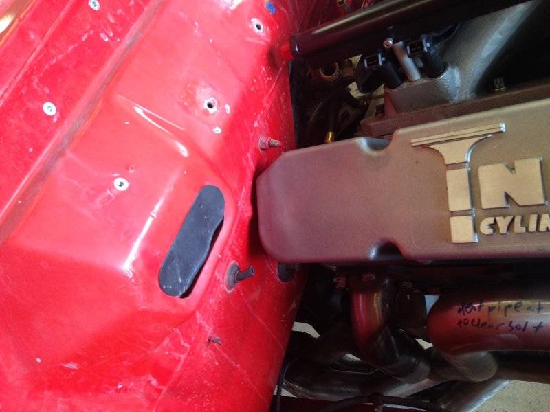

I'm using a 70 unit in my 65, moves the engine back about 1.5". Any heat/ac plumbing needs to get moved elsewhere since the expansion valve, lines etc are already close with the 63-5 k. Here is a pic of clearance now for comparison.

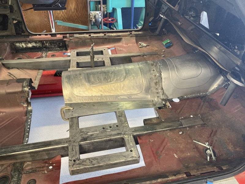

On my 65, I also needed to flatten out the pinch weld above the bell plus do some thumping on the floor to clear the various lumps/bumps on the trans. Add in some trans mount change too.

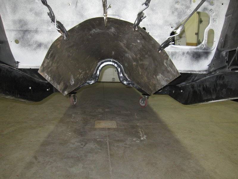

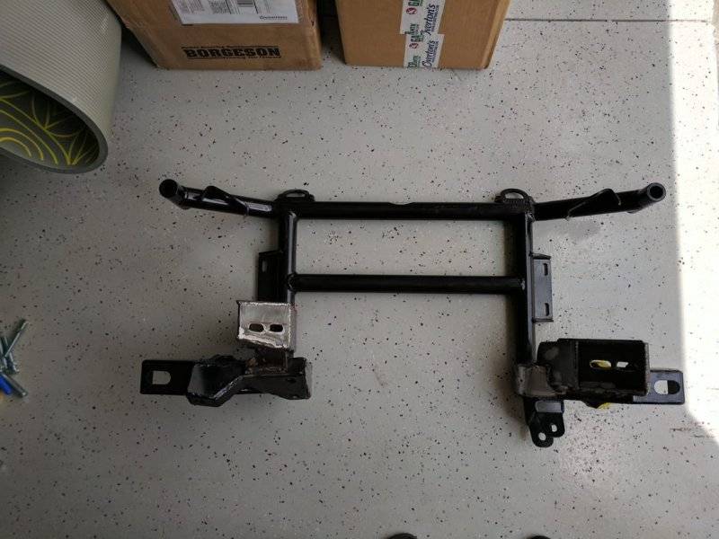

I recently built a "test stand". Since its "universal" I made a separate fixture to fit a k-member. Since I want to minimize any damage to a painted or powder coated k-member I made it so the K rests where two of the frame bolts would go.
My inside pic:

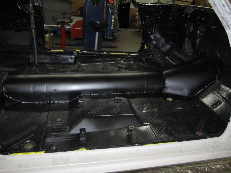

I should have bead rolled mine for strength but, my pal with the roller has died. So, I bought 3' of sch.40 10" pvc, ripped it lengthwise, and covered the tunnel so my upholstery guy couldn't dent the sheet metal. It will be covered with a console later.
Mike
