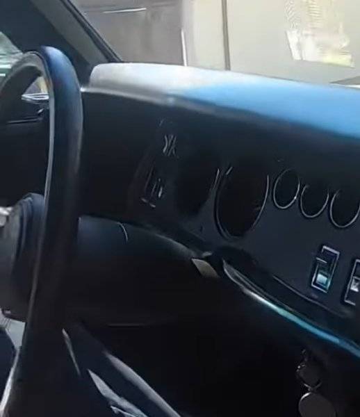

Here's a few screenshots of an awesome A12 clone w/the Tuff wheel. It doesn't look like the "accordion-wavy" type spacer was used behind the steering wheel. either.

I see a "plain black" spacer in the car I screen shot.
