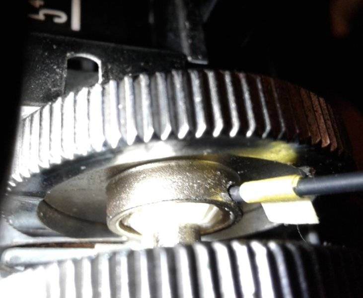

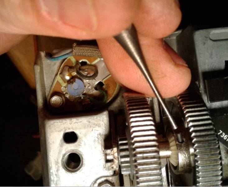

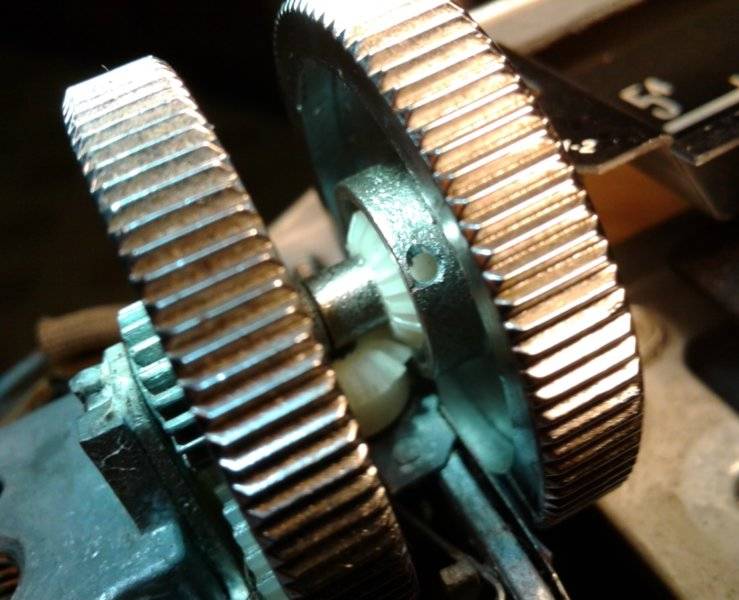

I took and drilled a small hole on the tuner wheel hub to the point where it drilled all the way though the hub. And then I continued to drill into the plastic gear a shallow depth. Then I took that drill bit and cut a section of it off the end to use as a pin. Put a dab of super glue on the end of the pin and took a small hammer & drift to set the pin into the hole. Tuner wheel spins fine after that shade tree mechanic job lol. Pics below to help explain it better.
EDIT. You won't see the pin once the chrome trim is in place. Just make sure that the length of the pin doesn't stick out too long as it would interfere with the chrome trim.

Thanks, for sharing. Wouldn’t epoxy work ?

Just be patient when drilling. If you have long drill bits, that makes it easier. Also try using a tiny drill bit first for a starter hole.
