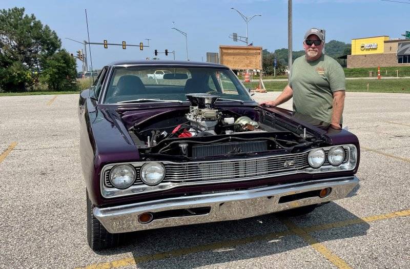

After some debate as to the feasibility and drivability aspects of making the change I decided to take off the Sniper FI system and go with a dual quad / tunnel ram set up on my 512. We are running pretty much the same cam, I have stealth heads and TTI Headers and Exhaust with an X pipe. I kept my electric fuel pump from my sniper system and just got a different regulator.
No I had no issues with the sniper system, it performed like advertised. Full discloser I wanted the look of the dual quads, it was an easy swap to install the tunnel ram redo some wiring and get it fired up. I am truly amazed at how easy the start up is, I tap the pedal twice crank it over and its running. (Yes even when its hot out.) Sitting in traffic and town driving has not been an issue. I do have to say that it took a few hours of tinkering with the accelerator pumps and throttle plate adjustments to get things running good and i will also admit that i still have a small hesitation when i stomp on it and go WOT from an idle but with the 4 speed it is easy to compensate for it (I would think with your stall it would never be an issue.) Over all I am very happy and the Smiles per Mile have increased 10 fold! I spend more time waving and giving thumbs up at 25 mph vs going 130mph+
My intake set up is dual Holley 4160 (450cfm) Weiand Tunnel ram, Lokar Midnight Series Throttle Cable, I got it all just clicking away on Summit no problem.
Good Luck you will enjoy it!
I have had people ask about the 450cfm carbs, I used the carb calculator from holley (Carburetors Since 1903 - Holley.com) that based on really wanting the everyday drivability aspect have really liked my choice. No loading up issues at all in stop and go traffic, For my use I will never see any power loss associated with my choice.
