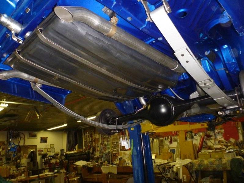

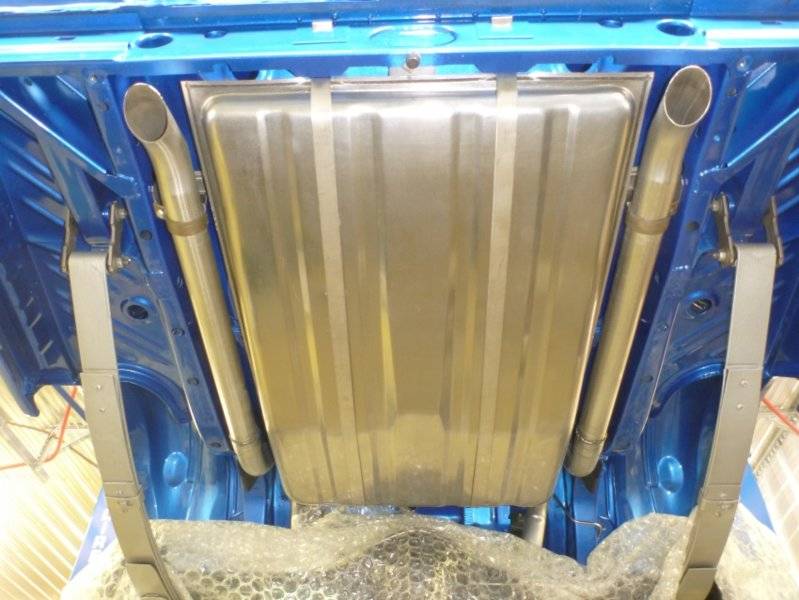

After picking up this RR, (69, 383), i w nt to change where exhaust exits....the tailpipes just turn down right before the rear bumper. Im wanting chrome tips just PAST the rear bumper.....prefer rectangle shape.....do i have to replace the entire tailpipes? Is there a "tip kit" i can retrofit?

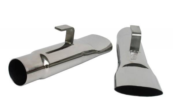

You'll need tips, new hangers and "Q" clamps.
I own cars with both styles.. and prefer my turn downs to the tips but to each their own.
I can put straight tips on the ends that turn down?
No, you'll have to cut off your tail pipes to fit the chrome tip length and get the correct new hangers for same. They use a special Q clamp if you want to do it OE correct, or just use regular clamps if you don't care.

Road Runner tips are oval,Dodge tips are rectangle.

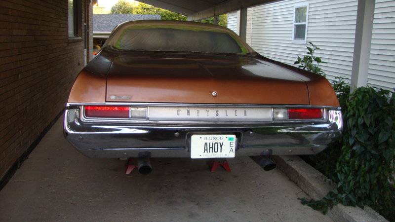

Could you put up a pic of what you have? What size are your pipes?
