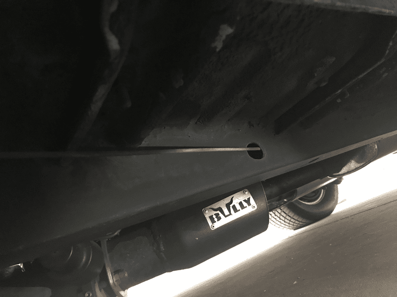

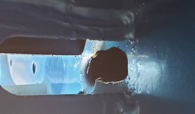

So , it's time to put in the 3/8" fuel line and the 1/4" return line. I really don't want to slice
and dice my new stainless lines up and have been scouring the forum and the net for answers.
The best answer I can come up with is to make a slot with a long burr starting at the original
hole, and cut a slot from there towards the right rocker panel until I can put the line in and
feed it through until it's in place. Even with the slots in the connectors, there's no way it will
fit without the slot in the torsion bar cross member. This is the only way I can figure out how
to put these guys in without losing strength. Any ideas or pic's? Thanks Guys!

Just trying to figure the best route for me. Making the slot in the torsion cross member is the
easiest because it's only about two inches long. Thanks!

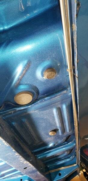

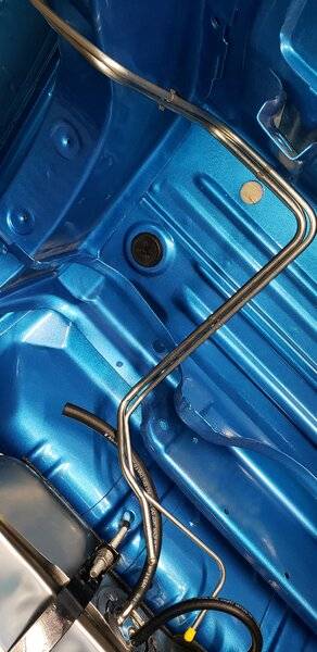

When you install frame connectors you obviously have to choose where to run them because you're creating a new obstacle that takes up the same real estate as the fuel line. I thought about it a lot and concluded it was easier to go along the inside. Going outside, the bends were a little more complex plus you'll have to cross over the outer frame rail and run it down to where the spring hanger is. That's sort of the way the factory did it but the line ran to the rocker. Frankly I felt less comfortable doing that way because #1 there is very little room in that spring hanger area and #2 the line would have been more exposed to road debris or what have you. Having it on the inside seemed like the best compromise.
What I thought about after the job was done was putting the line inside the frame connector itself before welding it in. You'd have to figure out how to route the line in and out of it but that's fairly easily accomplished by drilling a few holes and employing various fittings. If I had to do it again, that'd be the way I'd do it.

Like I previously said, I stuck a die grinder in the outboard slot in the passenger side connecter
and ground a slot starting at the original hole to give me a straight shot with the two lines.
Now to bend the lines around in the rear so they match up with everything! Phew!

Got Er Done! The Apollo PEX clinch clamps really worked nice. I used 3/8" and 1/2" clamps
and they fit nicely. Now on to the rear brake line on the other side!

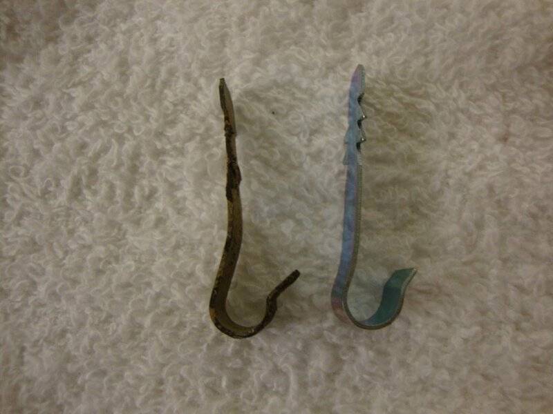

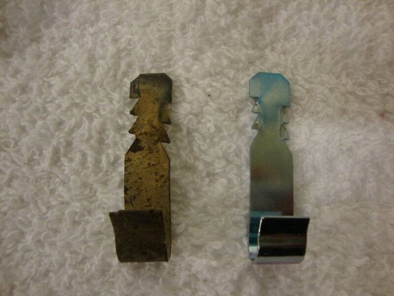

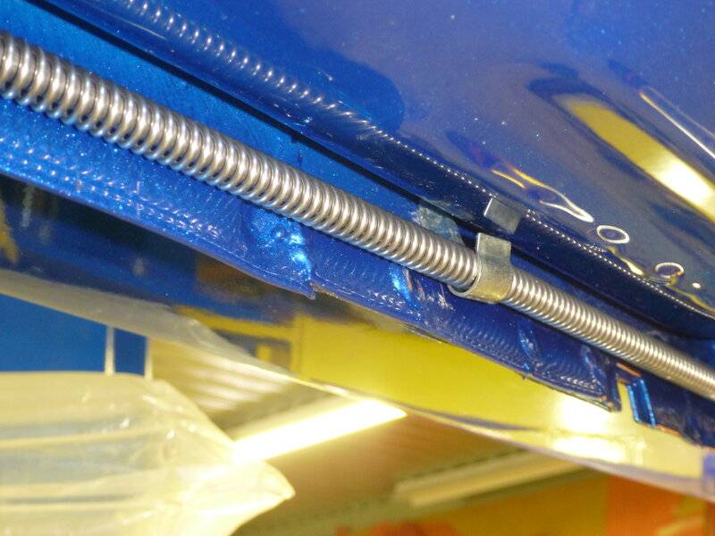

O.K., I've got one last question about these lines. Where the heck does this clip/thingy go????
Hammer them up between the bottom seams where the floor and rockers meet !!
So there's one spot on the rocker that is kind of void of clip holes so pick a spot in the
middle and pound er in! I got it! Thanks!
Hey, wait a minute! That's a brake line, not a fuel or return line!
