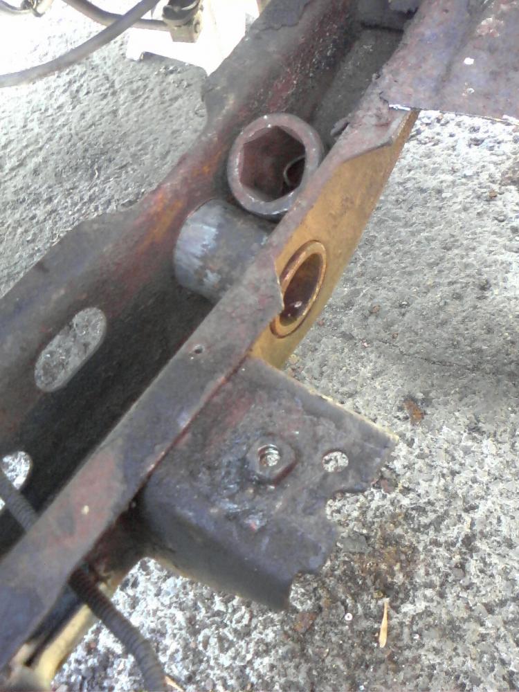

I am going to replace the rubber bushings on my K member with solids. I am thinking about removing the t-bar crossmember cutting the t-bar anchors out of it. Then welding those anchors into the tran cross member. This should mimic the 72 down setup and I would use 72 and later t-bars.
Has anyone done this?
I have measured and it's close but decided that for now I'm going to keep the longer setup and I had solid bushings fabricated for the ISO torsion cross member. I heve kept my spare anchors in case I do end up doing a larger tortion bar.... the 72 and down replacements are easier to come by and are reproduced.
Oh! the anchor fits perfectly on the existing holes too! The only real issue I see is there is not enough usable lip to hold the dust boot on.

If you want, I think I still have the specs I used to have them fabricated... relatively simple turning at the local maching shop in the material of your choice

I actually dont know if the anchors are different lengths in the earlier years, sorry. The ones I have showing in the pix are from my original chewed up 74 ISO cross member, I had to replace the whole thing.
I do know what you mean about the member being in the way upon removal but you can also look at it this way, it sure can help when putting the trans back in! lol
