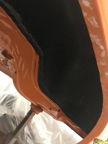

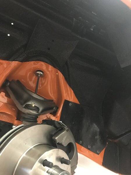

Here are a couple of pics of Resto Rick’s product if this helps.
F0D80861-94B1-482C-919A-E708321D0548.jpeg CB7D71B8-0F90-43CC-BB79-9F4B4CC85B63.jpeg

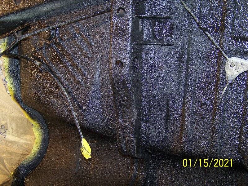

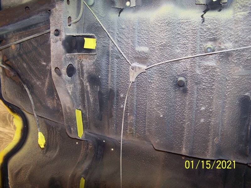

I used a three part Bedliner material that gets mixed and then sprayed out of a hopper gun (for drywall). It might be a little too bright in the photo but I would think the 49 year old stuff has lost some of it's shine over the years. I can get the name of the product if it is something you like. If I remember correctly is was about a $100 to do the entire bottom side of the car. Very tough stuff, no runs, no drips, and sticks like glue. It cures hard, not sticky. You can adjust the texture by changing the amount of kevlar you add to the mix.
View attachment 1205201 View attachment 1205202
that looks pretty close to what I have now
