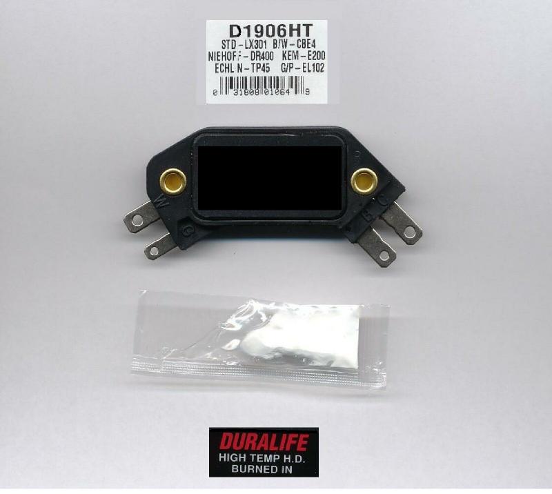

Is the module a GM HEI type like this:
They run about $25 ~ at most part stores. Here's a site that explains how to test it. http://forums.hotrod.com/car-craft/70/661769/general-car-craft-discussion/gm-hei-ignition-module-testing/

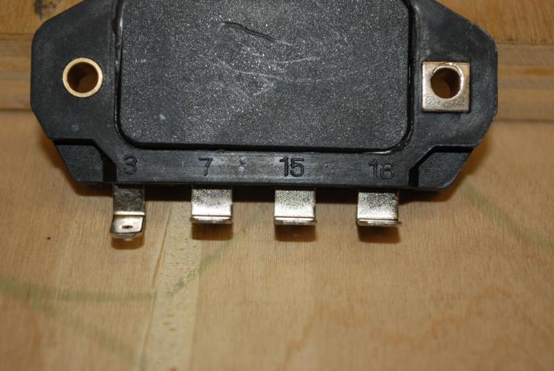

I took the cover off of the Skip White dizzy and the module looked like this:DSC_7949.jpg
#3 has a green wire attached
#7 has a white wire attached
#15 has a red wire attached and
#16 has a black wire attached
I had it tested and sure enough it was bad. After only a week of driving.
