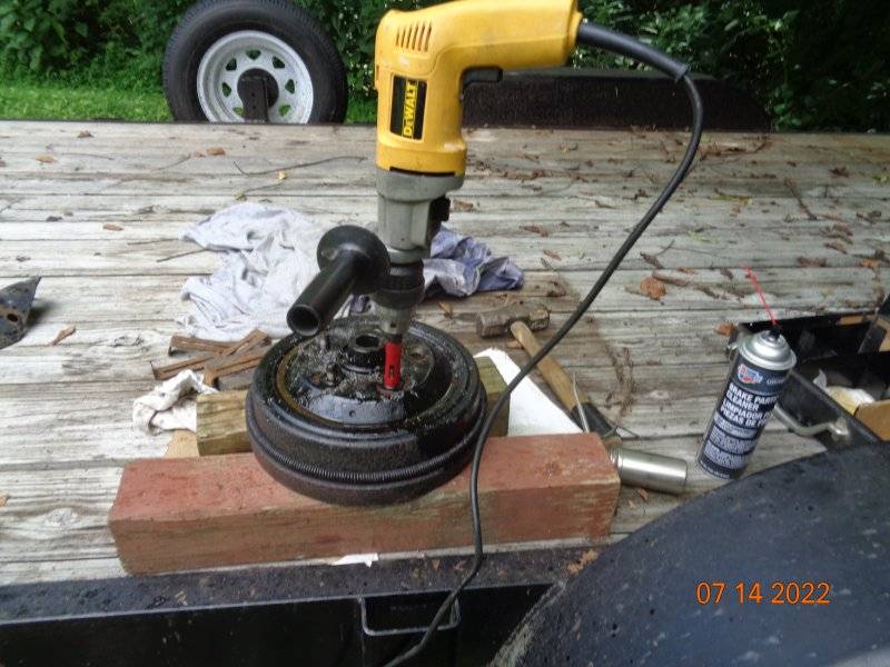

I bought the 5/16 hole saw that others have mentioned. It does NOT fit over the 1/2" stud and I deformed the threads on one stud and had to clean them up with a die. No big deal - I will try the 11/16. I'm just trying to get set up for eventually needing to remove the drums from the hub when we do need drums. These drums are at the limit.

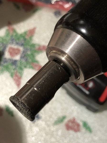

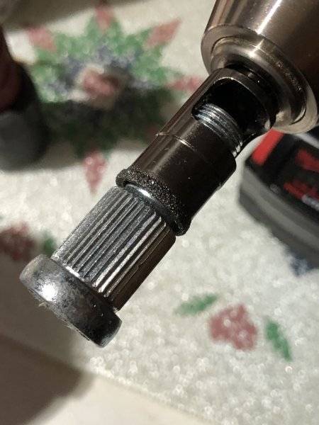

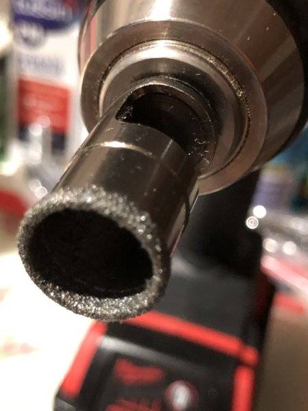

This is what I used. A diamond tipped 5/8” hole saw. It has a built in arbor. Not sure of the brand, my mind is going. But 5/8 was perfect. Lenox has on with the teeth, but you have to purchase the arbor to thread it into.
I think I just saw those at Lowes today...thought they were Lenox
That’s where I got it. And I think you are right, it’s a Lenox. I went to Ace Hardware the other day and saw the one with teeth. That is what I was looking for but they only went down to 3/4” at my Lowes. The diamond one worked great but it took a little while and pressure. I used motor oil as lube coolant, and did both front hubs.
This is what I used. A diamond tipped 5/8” hole saw. It has a built in arbor. Not sure of the brand, my mind is going. But 5/8 was perfect. Lenox has on with the teeth, but you have to purchase the arbor to thread it into.View attachment 1321186View attachment 1321187
That 5/8 went right over the stud threads? I tried a 5/8 with teeth and no go over the threads.
The 5/8 should work on 7/16" studs like A Body cars. Our B Body cars have 1/2" studs. I used an 11/16" hole saw, and it worked perfect on my 64
Plymouth rear drums.

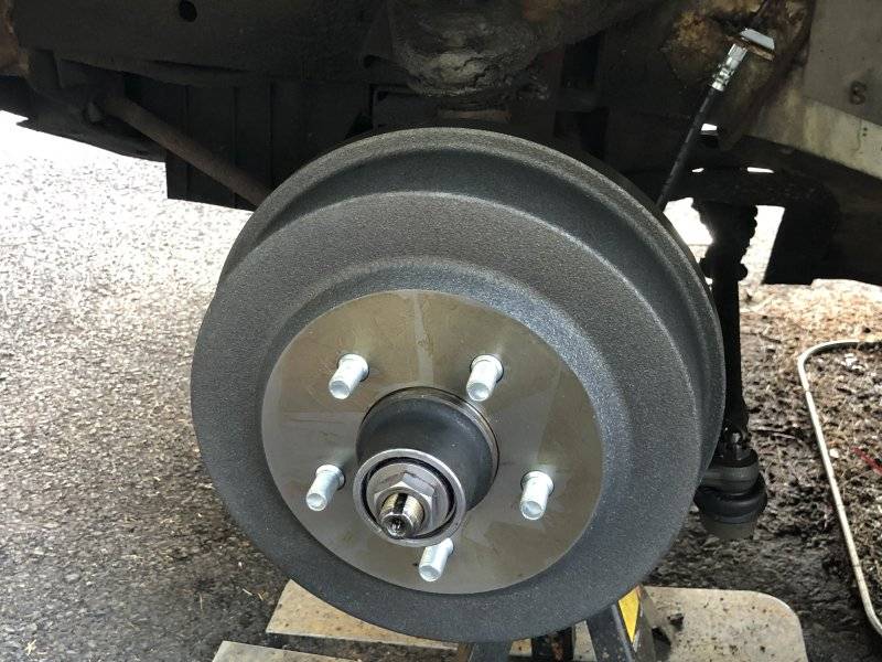

Yes, it did. In the pic of the hub, you can see a removed stud. I wasn’t trying to save them though. I switched to RHT on the drivers side and put new on the passenger side. Dorman sells them 10 a pack. I did end up going with the .65 knurl, as the .625 was loose. I took the hubs in work and on the Bridgeport ran a 41/64” drill to open them up to .641, then ran a.645 reamer for a .005 press fit.
Here’s a 1/2 20 Dorman stud in the 5/8 Lenox diamond hole saw.

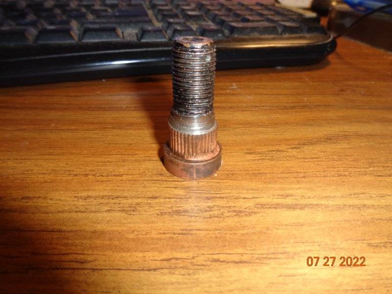

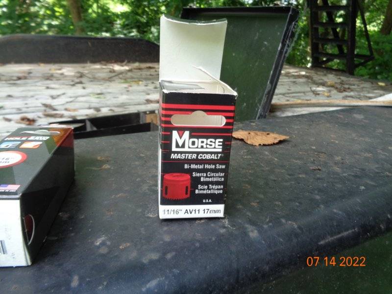

I bought a 5/8" hole saw before I got the 11/16" one. The 5/8 teeth would not fit down over the 1/2" threads. Looks like the diamond tip saw would though. But did it cut threads all the way down the stud before getting to the swages? This is one of my old studs after I used the 11/16'' saw. I was not worried about saving either the studs or the drum, as replaced them both on my rear axles.

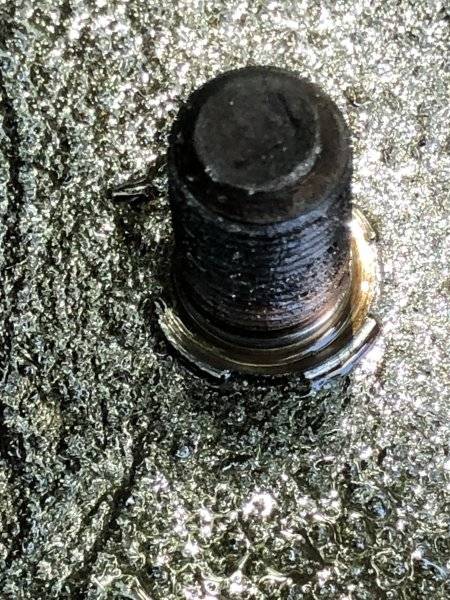

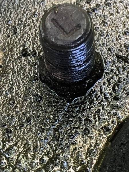

This is what the stud looked like after the Lenox 5/8” diamond tip hole saw.
Ready to be tapped out. As you can see it didn’t mess up the drum or the stud. However I was replacing both.
Here’s the before shot.
