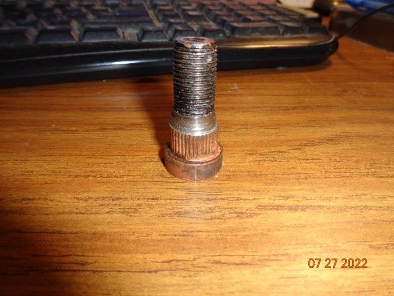

You could keep the studs by doing this, but the shoulders will be cut away and the drums will be trashed. It isn't too hard to replace the studs, but the left hand threads are not readily available. I happen to have one of my old studs here, and will post a pic so you can see what will be left.

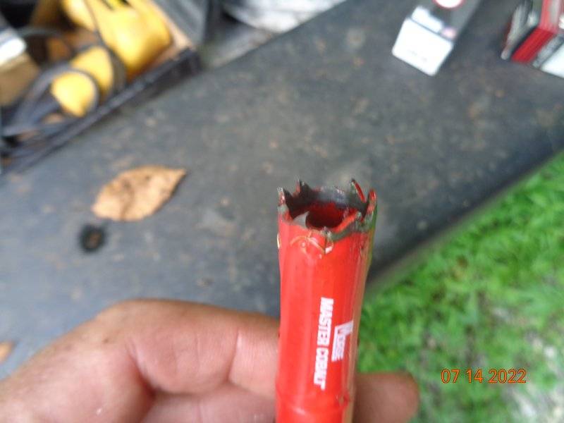

11/16" is correct for our 1/2"-20 studs. I think A body 7/16" studs will need the 5/8" hole saw. I got ten studs cut out with one of these. Broke off three teeth, but it kept working. Go slow and use oil....
