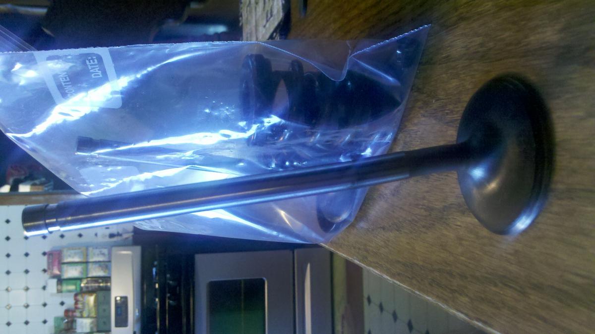

OK,,, Here's some interesting news for you to ponder!:happy1:
I ran through the comp test and found two cyl's at 0, "ZERO"! Numbers 1 and 7...
I did a leak test and heard it all going out the exhaust on these two. The other cyl's dry were at around 190psi, maybe a bit more... Hard to tell with the overlap on the cam, but a solid 190!
So, I pull the head and found both 1 and 7 had bent exh valves??? I can see where they touched the piston, but can't imagine how? I wonder if reving the engine with a bad cam made the lifters bounce off the lobe causing valve strike??? Not all the lobes that were bad on the old cam had bent valves,, so the valve strike didn't cause the cam failure.
Anyhow, the pistons appear to be fine, just a light mark from the valve on the thick part of the dome... I don't believe I have to worry... The valves bent at the under-cut area "weakest point". I removed them and inspected the seat,,, Doesn't appear to have any damage either!!! I think I realy lucked out on this one!!!!! I'm going to buy two new valves and set them in place then do a leak test with solvent. I might just lap them in to inspect the seal if they pass the leak test. We'll see once I get everything in hand. Worse case scenario is I have to grind the seats.
This is why the new cam hasn't sounded the best,, I had two dead cyl's!
Good news though,,, I got a chance to inspect the lifters and cam after breakin, and everything looks GREAT!
I should have everything Tuesday and begin putting it back together after work... AGAIN!
