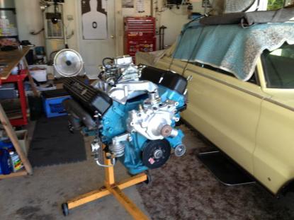

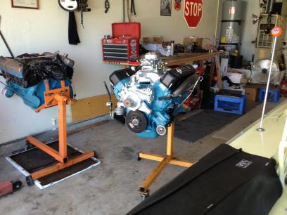

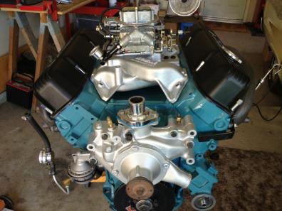

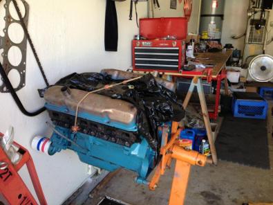

In about an hour I am going to be picking up my 727TF tranny from the shop after they have completely gone over it and fixed the problems caused by the first shop. I will give you all in a day or two what they found wrong and what was replaced and fixed. Let's just say that after all the $$$$'s spent on the first go around, the new $$$$$'s being spent should fix things up. But I will have to wait and see. Stay tuned....Tuck
Best of luck to you. With all the crap you have gone through on this car things have to be looking up by now!
As I told Tuck before he left. At least of this new motor knocks you should at least be able to drive it home with no problems. He laughed! We got it in, had a heck of a time getting the converter to fully seat, just need to hook up the lines and fill it.
Thanks Meep Meep. Well here is what we have. Seems the first place I had do the tranny did absolutely nothing when I had them overhaul it back in 2005. And I supplied all new parts for them as well. The second shop did the following:
1. Found that the Valve Body had the wrong Separator Plate in it. ??????? WTF???? They were having a tough time locating one or a suitable Valve Body to replace it with. So I decided to upgrade to a Turbo Action unit for automatic/manual shifting. This ride might once run down the track but for the most part it will be a cruiser. So a brand new Valve Body...I kept the old...in now in place.
2. Clutches were needed as the ones in there were very old. Again?????WTF????? I gave the first place all new Clutches the first time.
3. Bands needed replacing. That I am not sure about but the first invoice says they checked OK.
4. Installed a Heavy Duty 4 pinion Planetary gear set. That was supposed to have been done on the first overhaul.
5. Heli Coil the flex plate mounts for the Flex Plate. Seems I stripped them out. Don't know how but I got a kit and the did it for me.
After 500.00 plus the first overhaul and now approximately 700.00 for this over haul, plus the 285.00 for the Turbo Action Valve Body, the tranny costs for this project totaled 1485.00. I guess I could have purchased one that was a bolt on and go from one of the tranny Vendors out there, but I have been trying to build this on a budget. And as we all know, forget a budget as it never stays as one would like. So with the help of my Crew Chief Brother, Jon, aka 69a100 here on FBBO, we got the tranny back in and mounted and all linkage hooked up. Neutral Safety Switch wired, and the Torque Converter in place. That was a "BEAR to get set but it finally slipped into place and the correct distance was obtained per the FSM of 1/2 inch from Flex Plate Mounts to the edge of the Bell housing. Tomorrow a little Bench Racing and then either this weekend or during next week we will get the motor installed. Other than fluids, lubes, sealants, etc. small stuff, I am done spending any more on this project. If the tranny turns out as well as the work the shop did, and the new motor doesn't give me any fits, I just might pull this build off at exactly 8 years in progress. Also for you NorCal guys up in my neck of the State, you need a good reliable local Tranny Shop, then I strongly recommend Vacaville Transmissions on Davis Street in Vacaville. MOPAR motor heads and a buch of really super guys. Besides...They got a really cool Shop Dog. Kudos to Vacaville Transmissions. I didn't include any pics for you all on the tranny but the motor looks like this. First pic is the old one....Stay tuned for more UPDATES...Cr8crshr/Tuck
