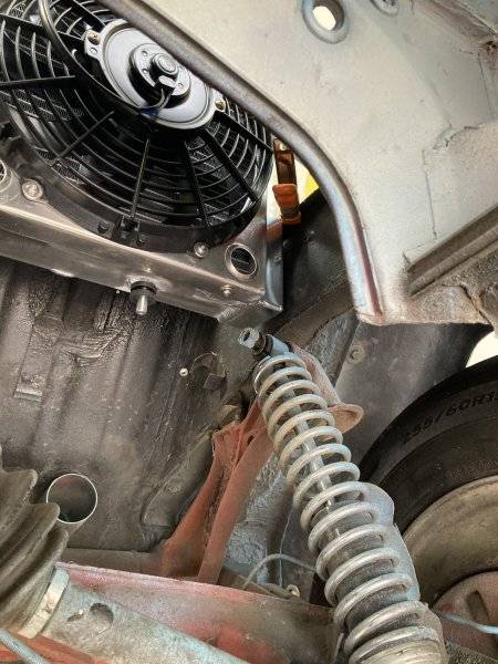

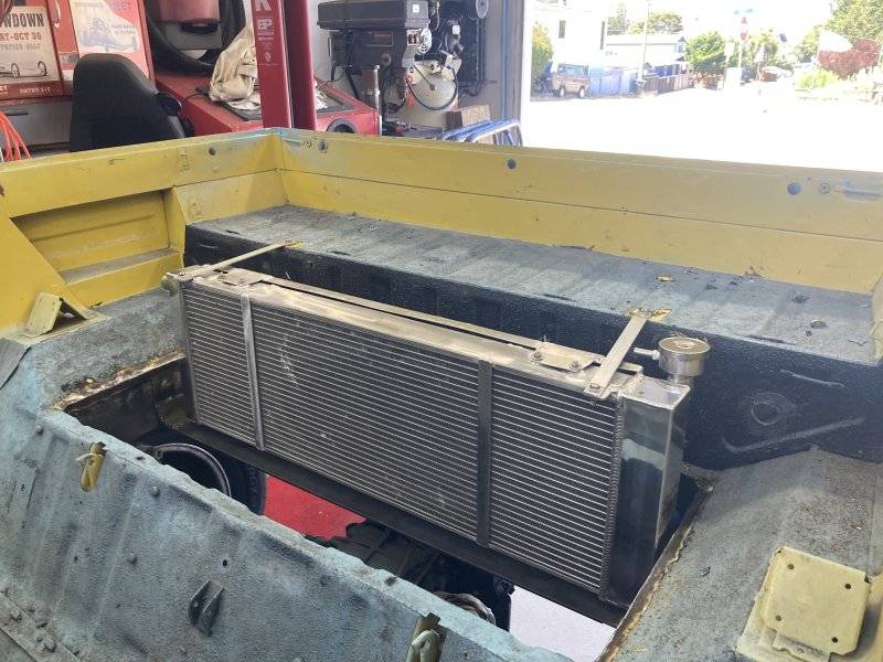

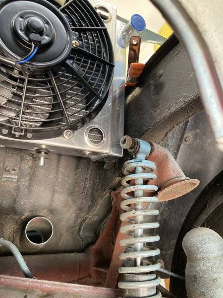

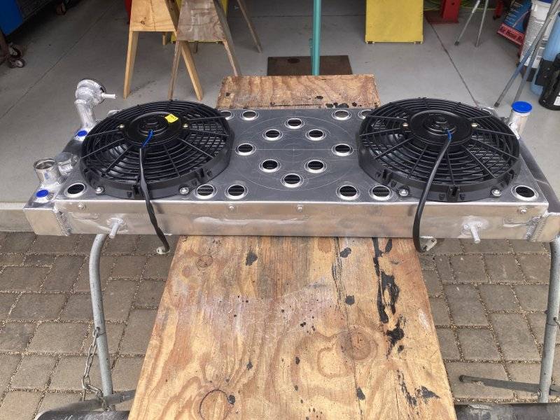

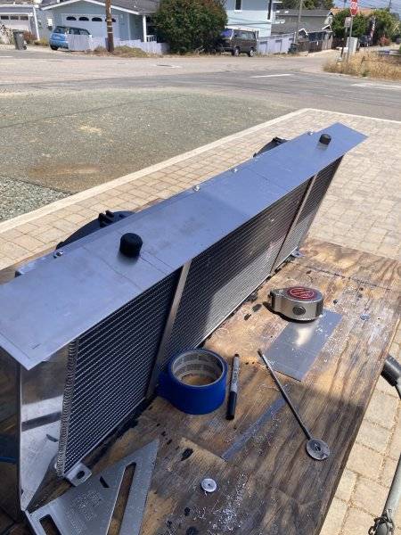

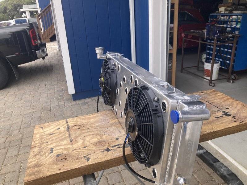

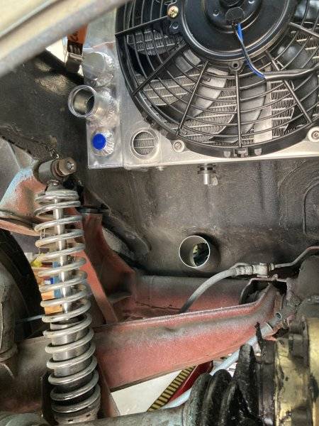

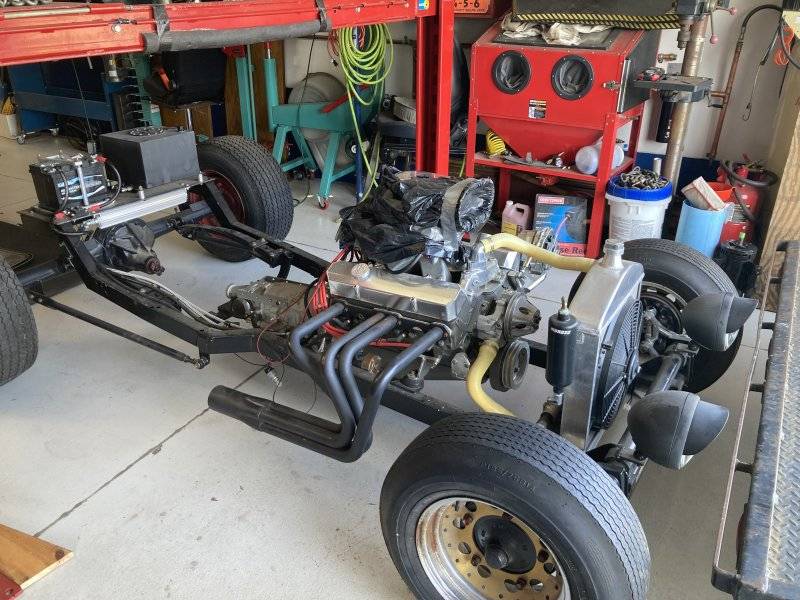

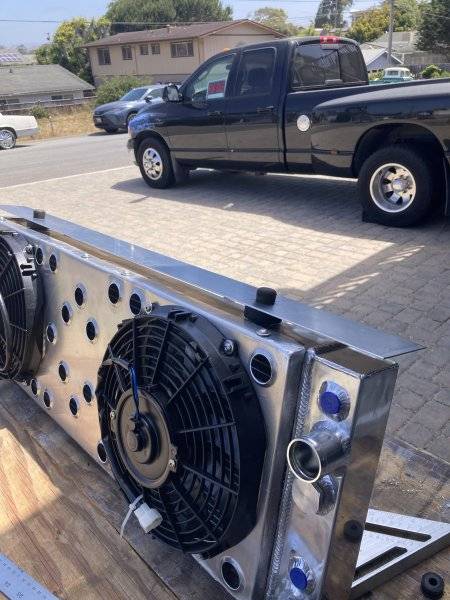

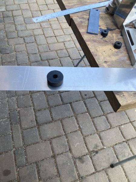

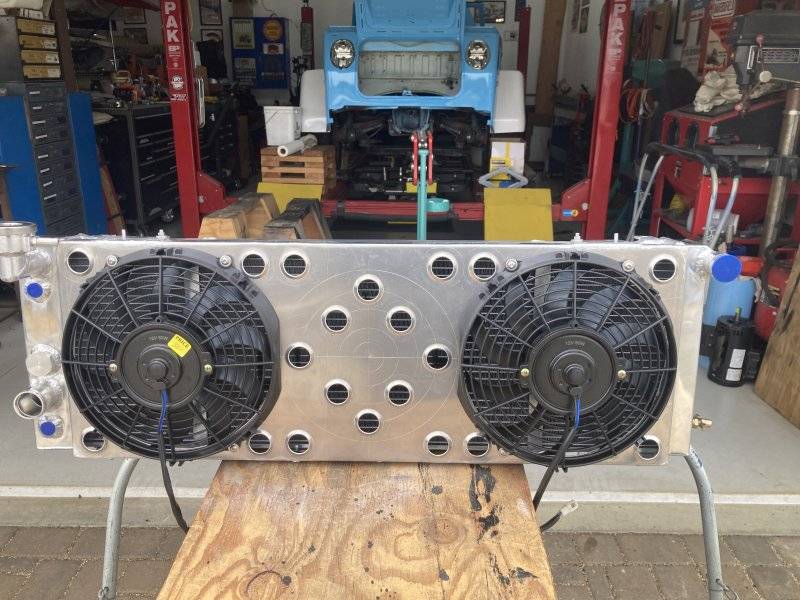

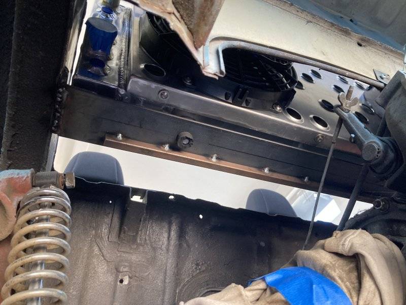

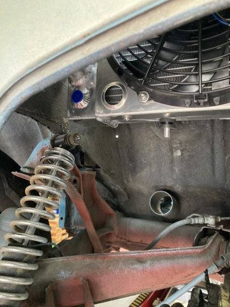

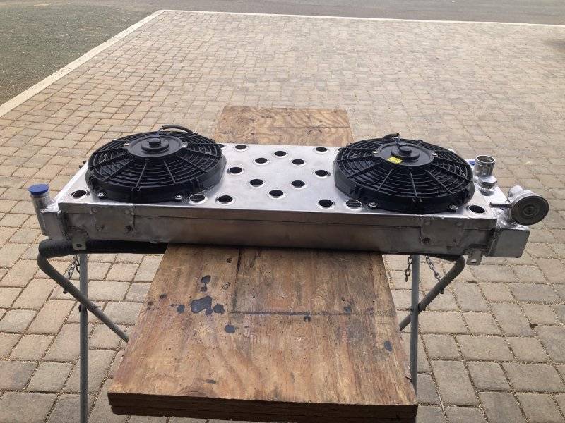

Fan shroud/mounting is done. For down the road if an 8" unit is needed, there is a spot already mapped out in the middle.

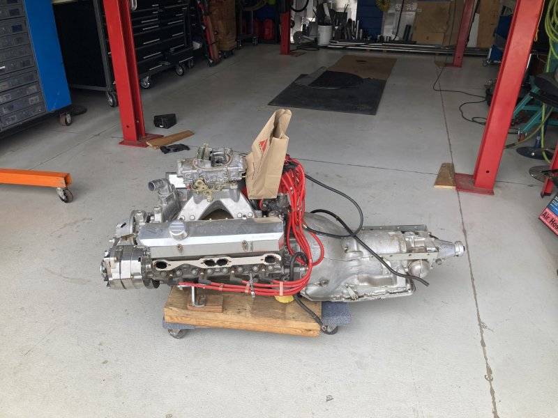

Fresh, usual components plus a Borgeson box and pump from Peter. Stocker is leaking. For the wagon. On the 65, already have his box.

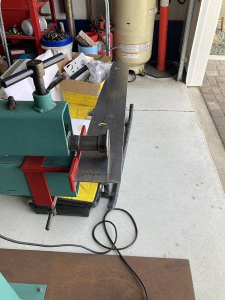

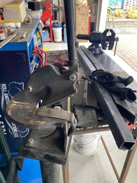

While I was waiting for the new project to show, I picked up a throttles sheet metal shear from a local auction house. Been wanting one of those for many years. Some day I'll get a stomp shear too.

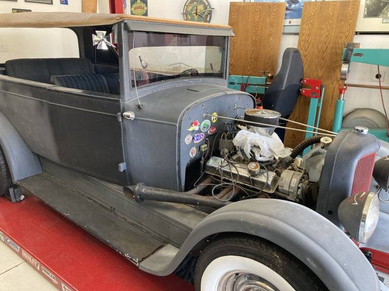

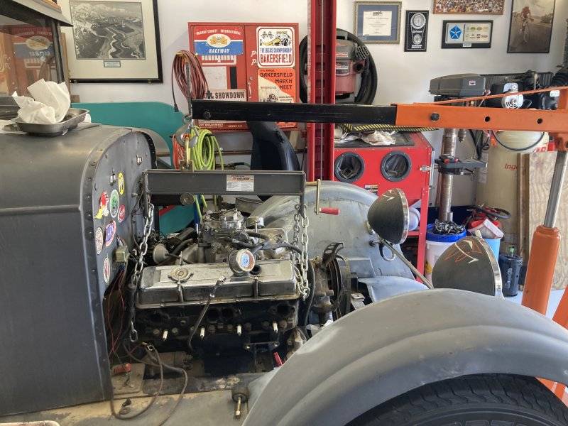

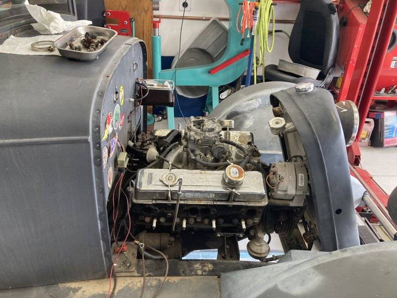

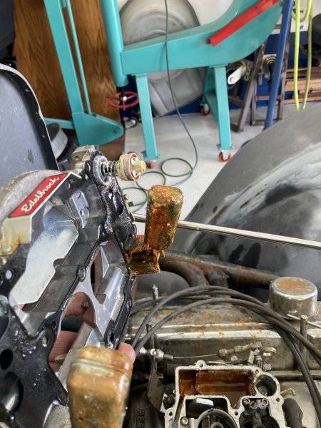

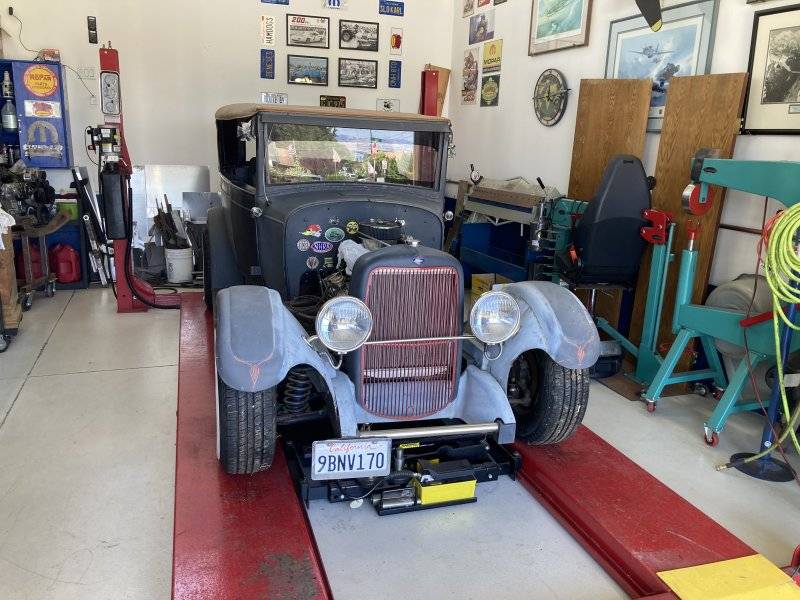

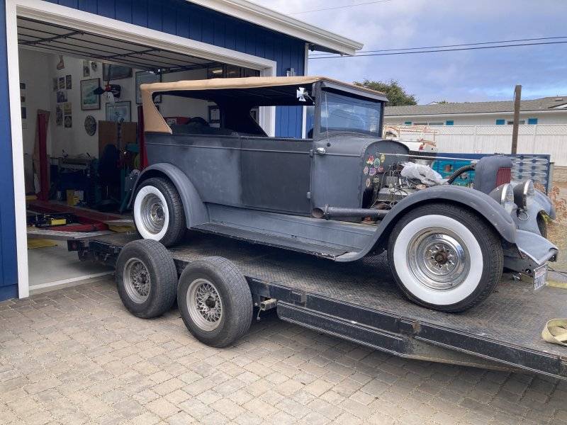

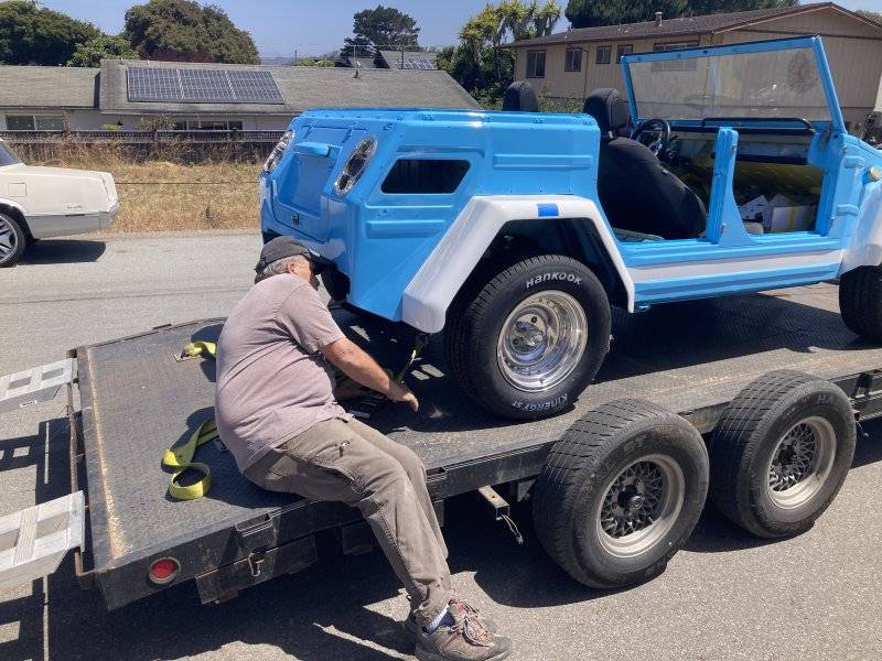

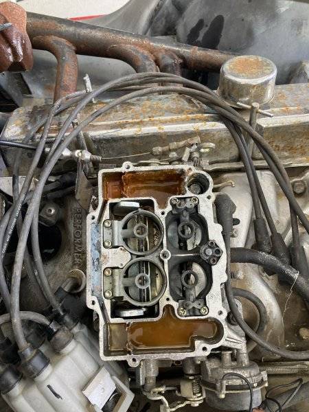

The new project got dropped off today. 28 Ford with a 350/350 combo. Has not run in over a year. The owner said whoever worked on it last toasted the starter from trying to get it running etc. Got it on the lift and just started running the vacuum on it to pull off weeds, webs, junk etc. Started running a list of needed fixes etc. One thing that bugged me was the aluminum fuel tank with pump gas in it thats been sitting for over a year. Alcohol and aluminum don't get along. My first view into the tank was surprising. Looks clean. A win so far. Get up to the engine and started inspecting. Points are toast, wires too long. I did see a ballast resistor so thats good. I did put my trickle charger on right from the get go. No clue yet what shape the battery is in just yet. Started pulling the plugs from the rh side as I wanted to turn the engine over by hand first before hitting the starter. Got #6 plug out and received a steady stream of water. WOW! Other two on the rh side were fine. Pulled #1, got more water, but not like 6. Other 3 look fine. Pulled the lid off the carb. Toast from water sitting in it. Whoever worked on it didn't seal anything up topside and the owner neglected to follow up. Engine time! He does have another rod with a running, at the time of purchase, 350. He'll bring that by tomorrow and I'll yank that out of it and he'll take the carcass back home. I'll do a swap of the two units. I'm going to get it running first then tackle the other needs. It pays to not immediately go to guns on something you're not sure of.
