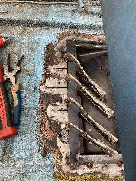

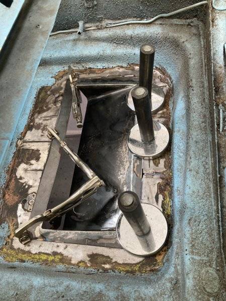

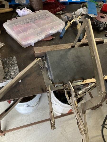

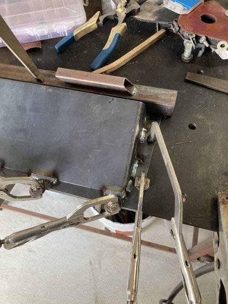

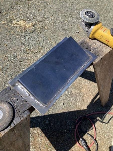

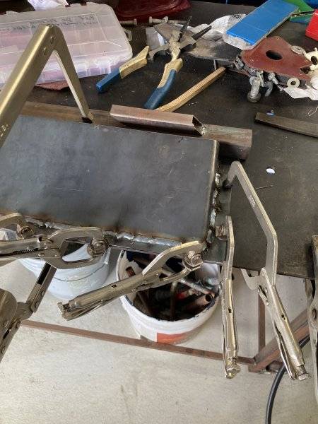

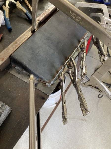

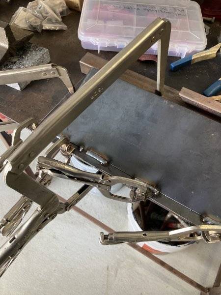

Got the scoop made today. Tomorrow or Monday I'll put it in then work on the other two holes.

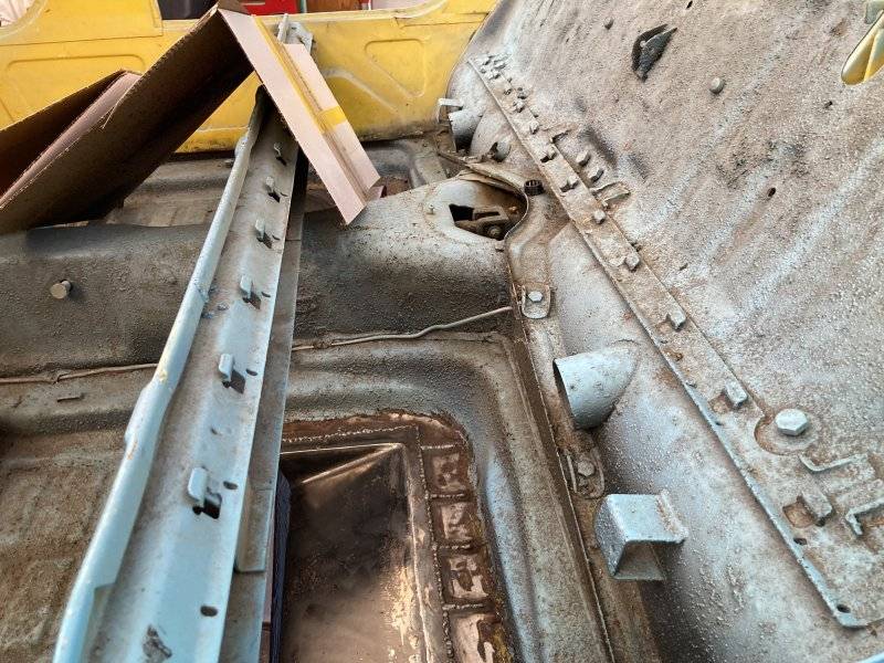

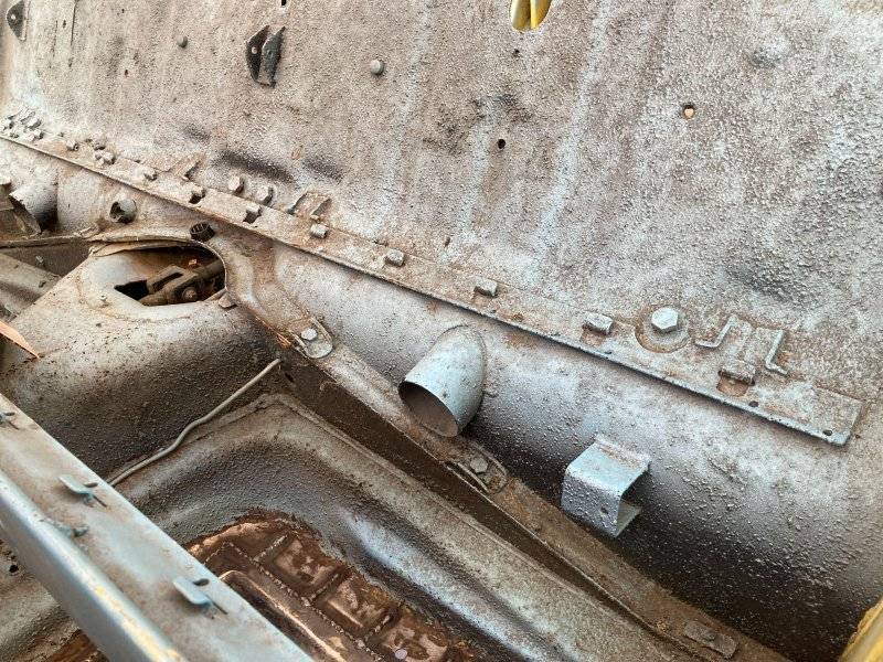

Got the scoop secured today. The area where the rear seat goes, you can see the hooks for it, is where I plan on taking out the two 2" round sleeves and making up a couple of oval ones to put in. With the butt portion of the seat in, plus there is some sort of vertical panel just in front of it, I can make this a fresh air intake box to help feed the air into the radiator which will be on the other side. There are also two air intake ducts that go on the outside of the quarters. These will get split on the back side so one portion feeds the radiator also and the other blows across the engine. I will try to seal off the intake side of the radiator as much as possible to aid the airflow through it. I don't want to only rely on the fans to keep the engine cool.

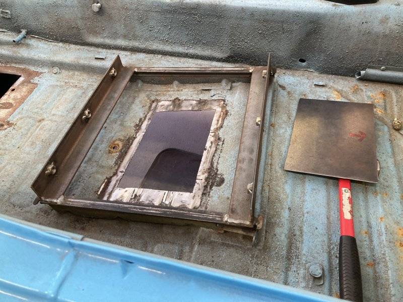

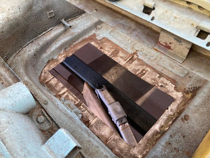

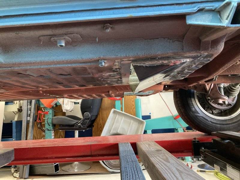

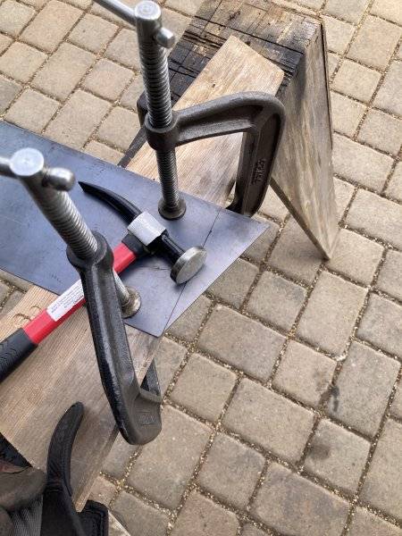

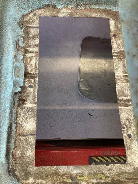

Spent some time prepping the rh floor areas. Lots of rust dust was created then vacuumed up. From there I slit the bead rolls and did some hammer and dolly work to flatten the areas out some. After that I marked the currently cut areas with a ruler/sharpie combo so I can true up the edges.

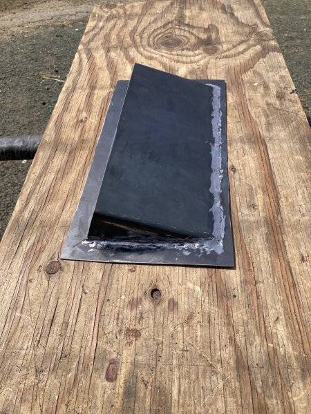

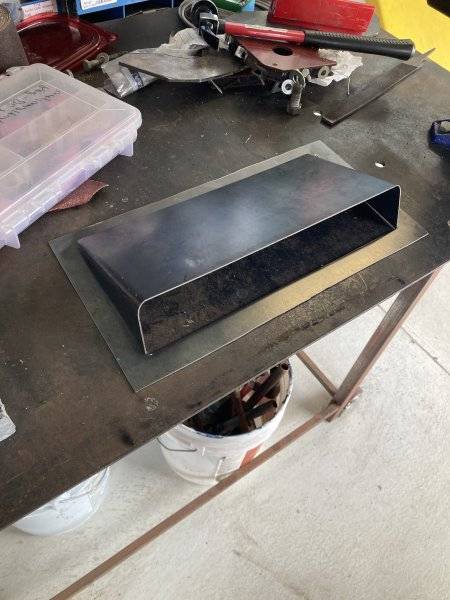

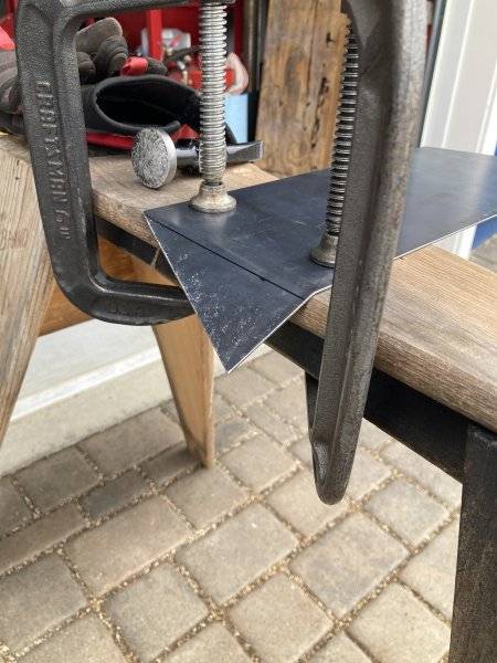

Got the edges evened up on the two openings. After that I measured and marked out the filler pieces. Also cut the piece for the soon to be made scoop.

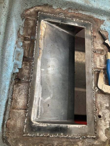

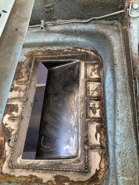

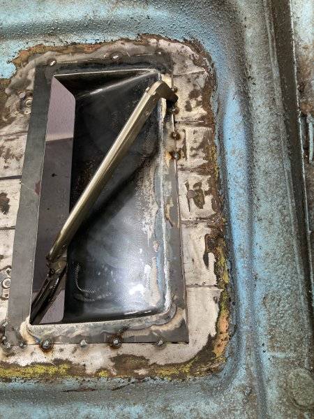

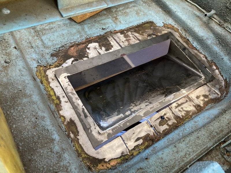

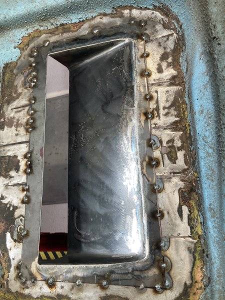

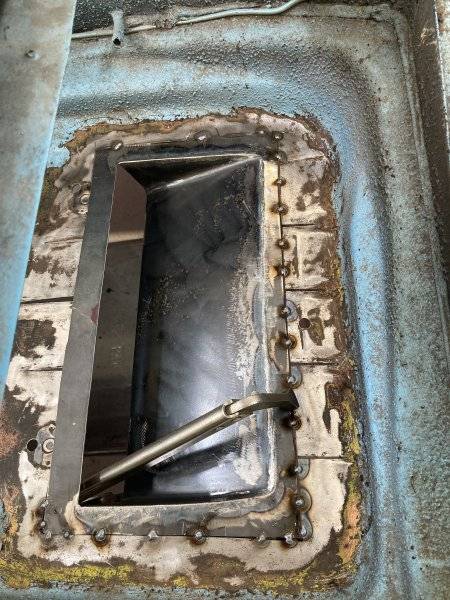

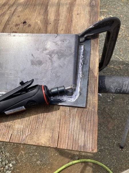

Today I was able to get the scoop secured in. I'm guessing the battery for the car used to reside in this area as its very thin and rusty. It took me almost 2 hours to work my way around the perimeter welding. Used several pieces of flattened copper for back up. Had to do fast trigger pulls and releases on the gun. Nothing like welding shim stock.

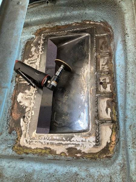

Got the piece under the seat welded in today. Went much faster since I wasn't having to mess with shim stock. After I got that done, put the tools and welder away, then started grinding welds. Lh side first. Going pretty well but I noticed the air grinder kept slowing down. WTF! Pulled my blue tooth head set off and checked the compressor. Had 50lbs showing on the gauge. Weird. Flipped the switch off then on and all I got was humming. Pushed the reset button on the motor, no change. Kept checking stuff out. Looks like the motor went boobs up. I heard some noise from it when it did spin about two revs, then out came a spark. Going to chase down a replacement motor tomorrow. It's 20 years old but hasn't had a huge amount of use. Compressor is an IR unit, motor is made by Emerson. Took pics of the tags. Will see how I do.

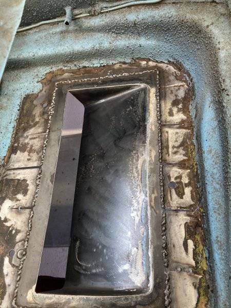

Back to work today on the v-dub. Finished grinding the welds down on the topside. After that was done, hit the passenger area with the vacuum to get the grit out. Tomorrow I'll work on the roadside, rough up the new metal, then get some paint on the new pieces. After the paint has set up, I'll get some seam sealer on those weld areas top and bottom.

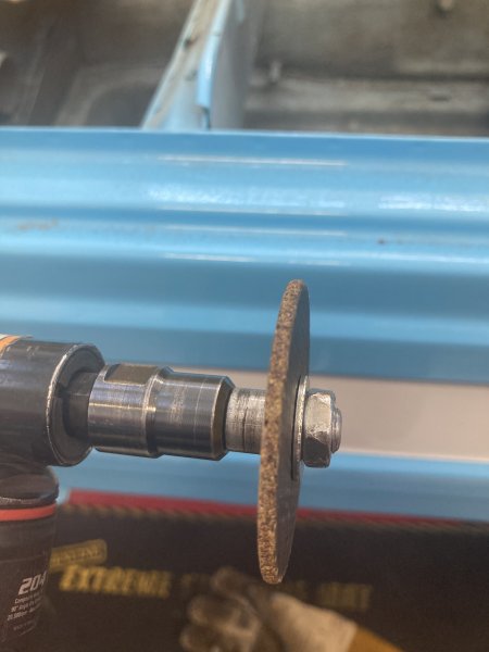

A tip I learned awhile back for you fellow gents. When using grinding wheels, they can get filled/gummed up and stop removing material. What I do is flip it over. Cuts like a charm then. When it stops cutting, I flip it again. I can do this on my electric 4.5" one too, you just have to watch where your fingers are and the offset of the wheel.

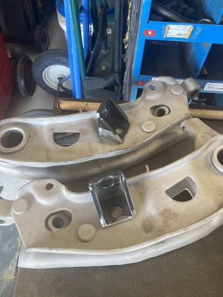

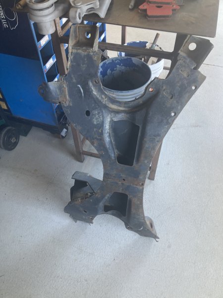

Had a good weekend in Van Nuys last week at the Spring Fling. Got some pieces for the wagon. Scored a good 70 K-frame, a Street Dominator manifold, caliper mount brackets for the 11.75" rotors, a set of 5 decent wheel covers and some other pieces. The manifold will get injector bungs put in, along with rails to match, for a down the road EFI conversion on the wagon. One of my neighbors pressed out the lower control arm shafts out of my spare set of arms plus blasted them for me too. I'll weld on tabs for the sway links. The K will get a little work on it. I'll cut windows above the control arm shaft sleeves, weld the sleeves to the K on the front, then weld washers around the openings for reinforcement. I'll get a skid plate soon too. When that stuff is ready, get them all coated. I'm gathering up pieces to redo/update the old, worn and soft setup the car has for the suspension. Brakes will get updated too. Green bearings on the axles will get the boot and tapered units will go in. When I tackle that stuff, after I have all of the items, the v-dub will get moved off the lift and the wagon on. I'm not going to creeper dive that project.
