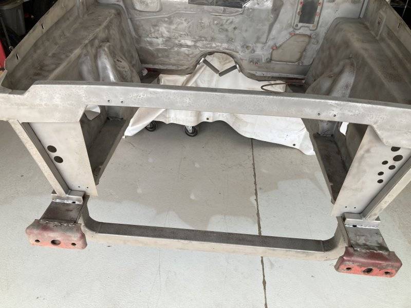

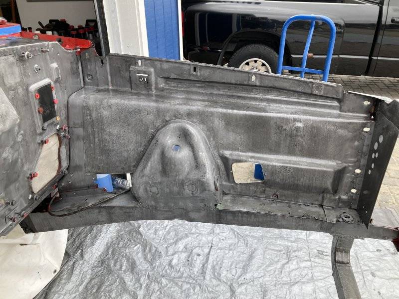

Some more shots.

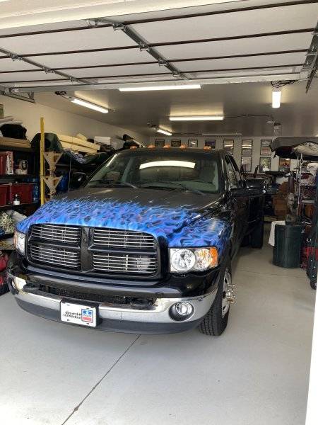

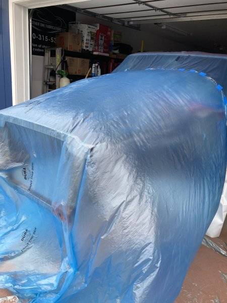

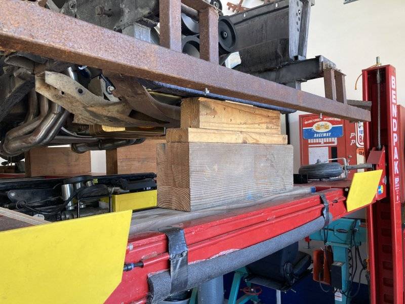

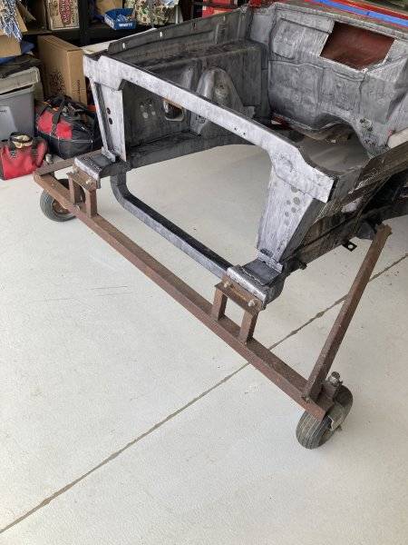

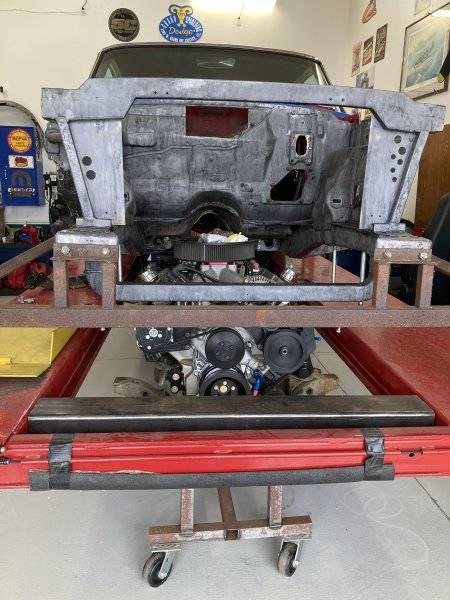

Like the commercial says, "that **** gets on everythin", or something like that. Looking good!Today I got it off the stands and ready to be moved to the other side and back on the lift. I was amazed how much dust from the blasting, even with my tent, landed in the garage. I put a new main filter on the vac plus a fresh bag and got the area around the lift cleaned. Put the reclaimed media in my blast cabinet so now its ready for work. After I get the car to the other side I'll clean the occupied area, move some stuff around and park the truck inside for a change.

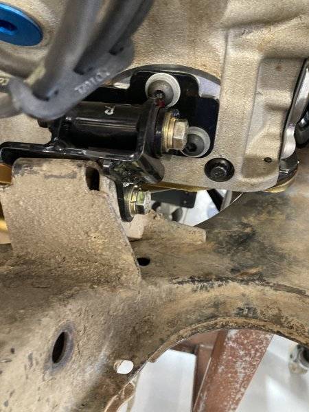

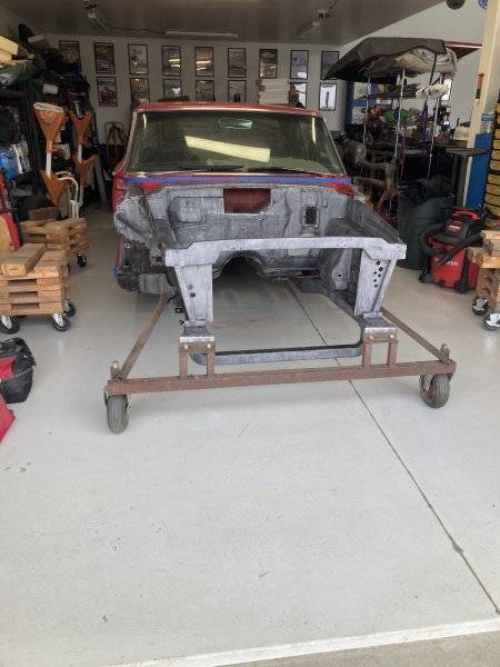

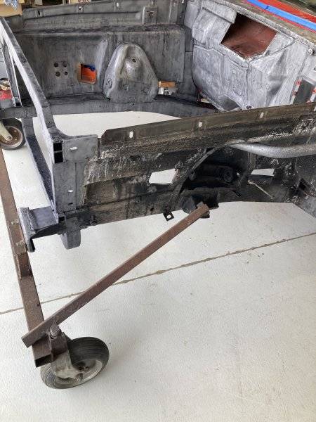

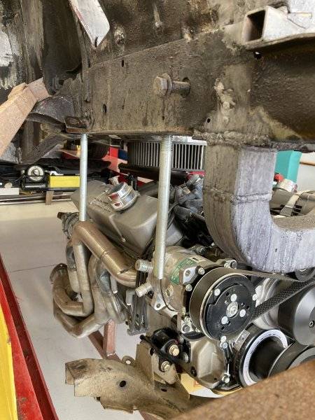

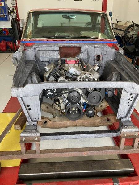

Maybe I missed it, but why isn't the Kmember painted?As of 11am, the engine/trans are back in. You can see the long 5/8" bolts with the heads cut off that I use to line the unit up with the car. I do need to either spend some time on a grinder to give the cut ends some taper or have them chucked up in a lathe to do the same. Would help out some on the alignment. This afternoon I'll be moving stuff around so I can park the truck inside.
