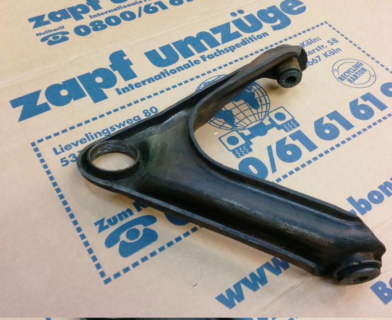

Hello,

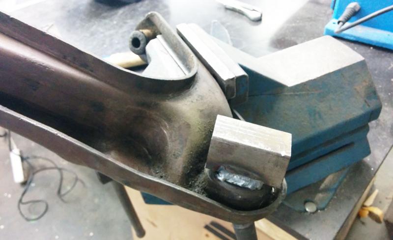

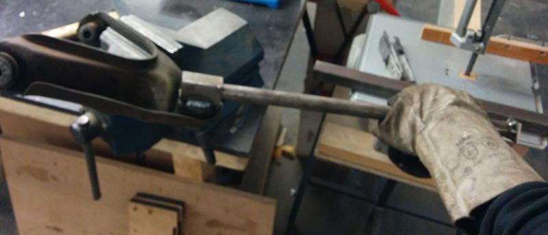

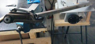

I just removed the ball joints from my upper controll arm. I welded a tube to the top of the ball joint. It will die anyway. Now you have a one meter arm and it will not skid off.
Loose the fist half turn counter clockwise than cut off the now needless 95 centimeter of the pipe.
Take a smaller pipe and with some back andt forth and a bath of of Mos2 the ball joint will come out.
The winding is still intact.
best
caspar

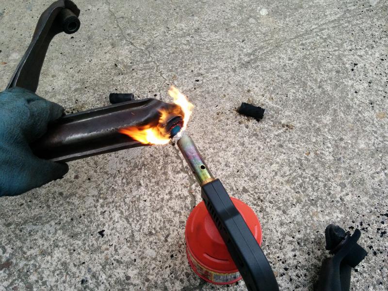

With a little bit of heat it will pop out by itself.
