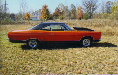

Upper Cowl Issues... 65 B ? You to ?
GTX69- what's the story on your Maxie car? Plymouth/Dodge? Auto/T85? Options? Gotta love the fenderwell cutouts:)

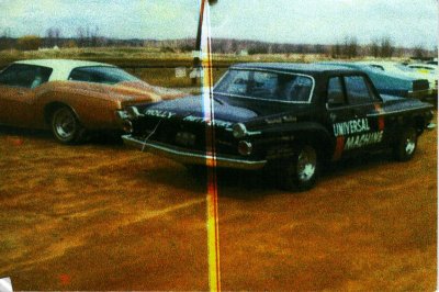

Hey Ruby just curious what's the purpose for the big holes in your fender wells, if their is one? :edgy:
Yup, the car had fenderwell headers in place back in it's racing days when the original 426 was still in place. It was very common as I don't believe under chassis headers were available for these cars then.
Well at least they didn't hack up your shock towers.It is a max was a t-85 auto trans was put in 1963.Restoring car repacing cowl and both fender wells and shock towers.
Yeah, while they didn't cut the shock towers, they cut, torched and smashed plenty of other places on the car... Good thing the car is over all very solid with mint floors framerails and trunk floor. Is your car a '62 or '63? Any other pics?
This is a old picture of it.I will post other pictures of it later .It is a 62 soild eveywhere else but cowl and fenderwellsThis is one of my other cars.dart.jpg
