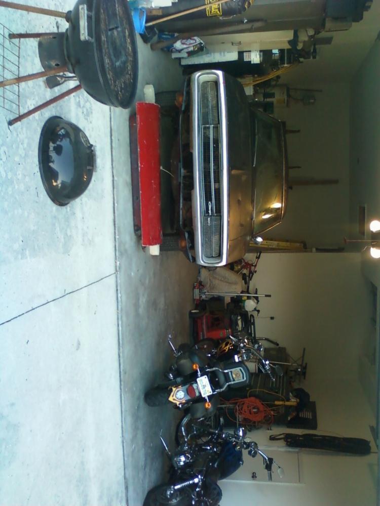

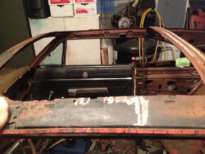

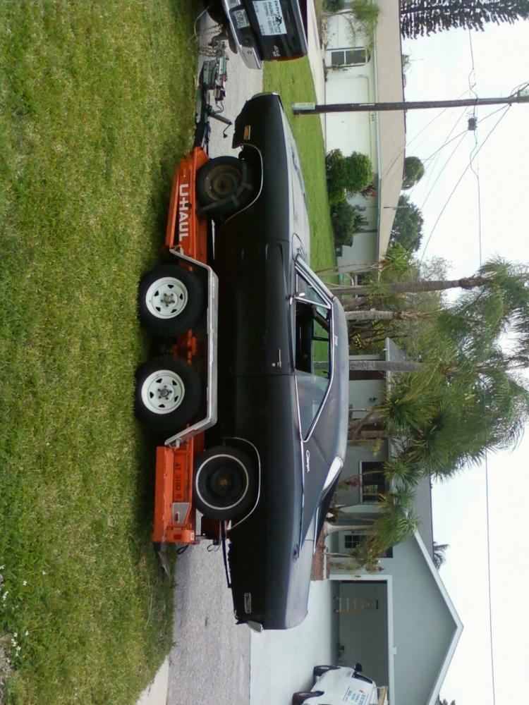

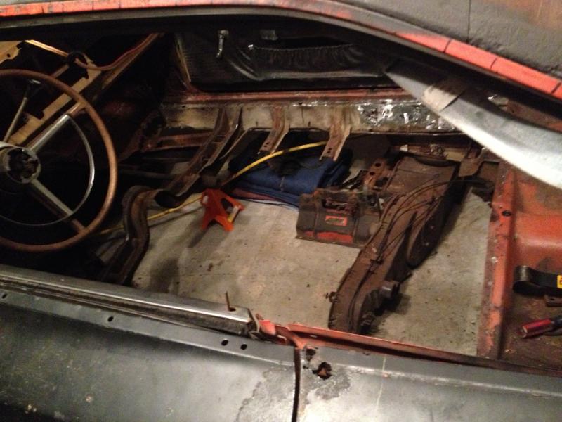

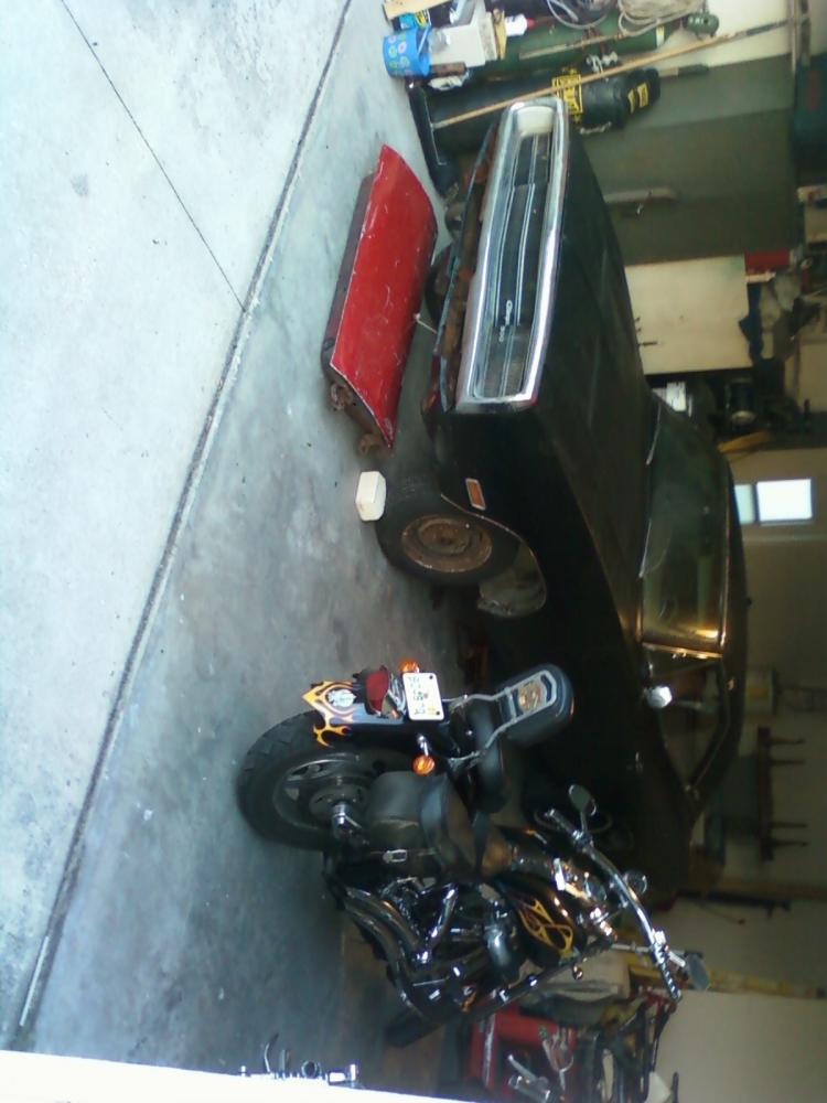

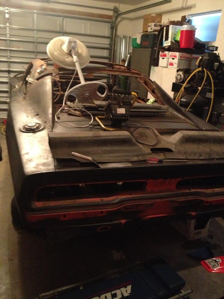

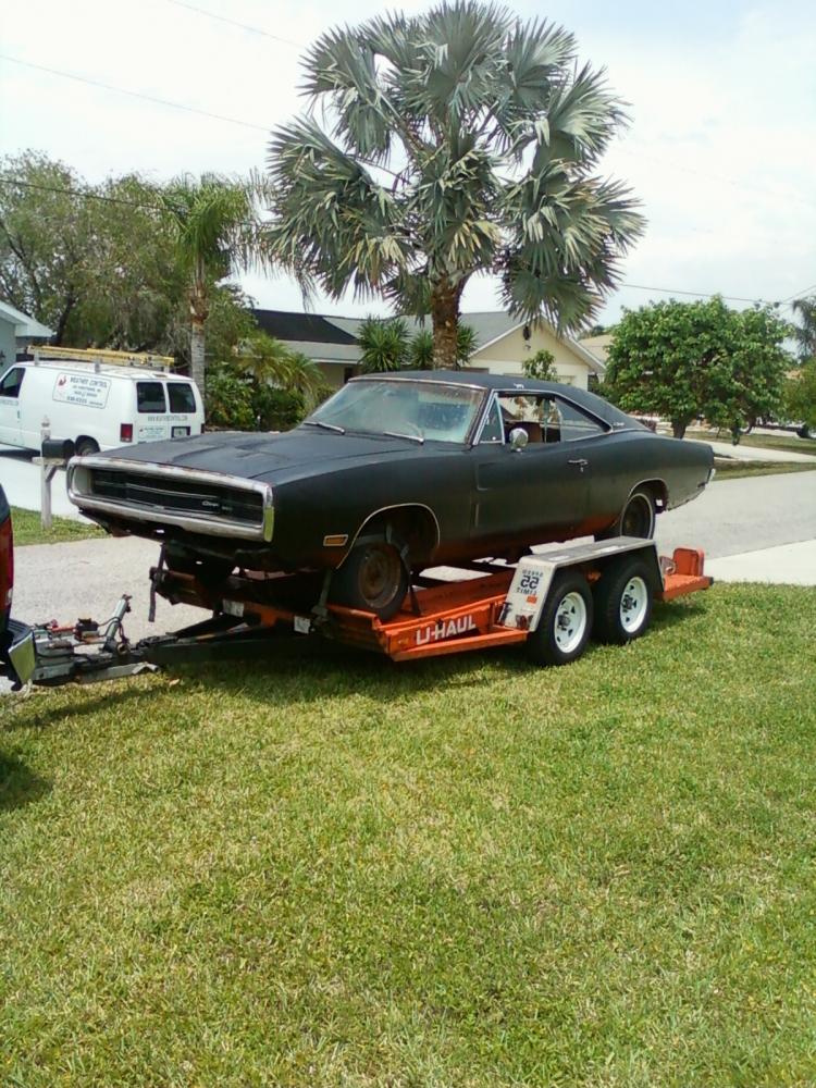

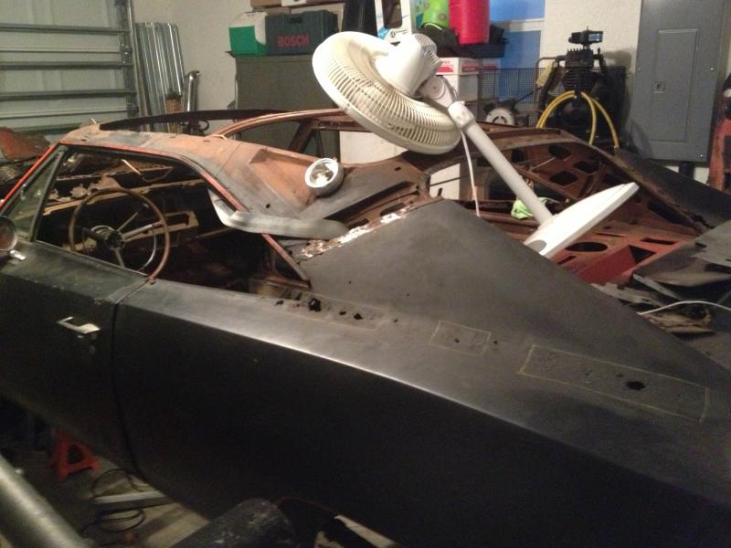

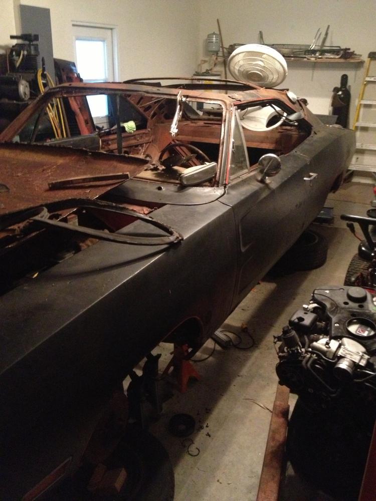

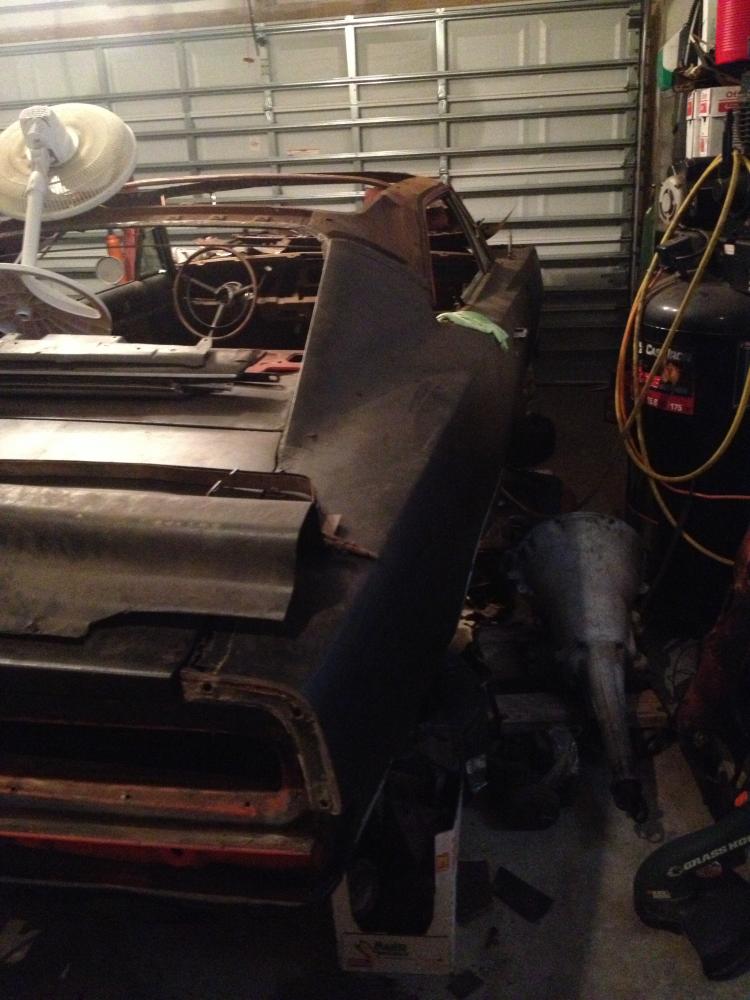

Hey Cranky the measurements from side to side is 45". I tried uploading a few pics of my labor of love when she came home and got in the garage where she will be for AWHILE, but not sure if it will work as this was my first post here, although i have been following this site since i acquired my baby and love this site because of how helpful and friendly everyone is here, GREAT site, and again, thanks for the quick reply guys! My project is slow going due to work and time constraints but i will post pics from time to time of the progression.
Yeah shes rough and gonna require new roof skin, front full floor pan, rear footwell area, trunk pan, deck filler panel, lower plenum, rear frame rails ugh!, tailpanel crossmember, and probably gonna go with a new fiberglass hood, and of course a few patches here and there. I know its a lot but its my dream car and just couldnt see it go to a crusher!

I just need to get the roof skin back on before i pull the first frame rail for replacement for structural integrity. right now i have it up on jackstands at the designated load bearing locations and both doors open and shut fine, but i want that roof skin back on since the floorpan and trunkpan is completely out. Im going to replace the rear framerails after the roof then she goes on the rotisserie:) of course in due time.
