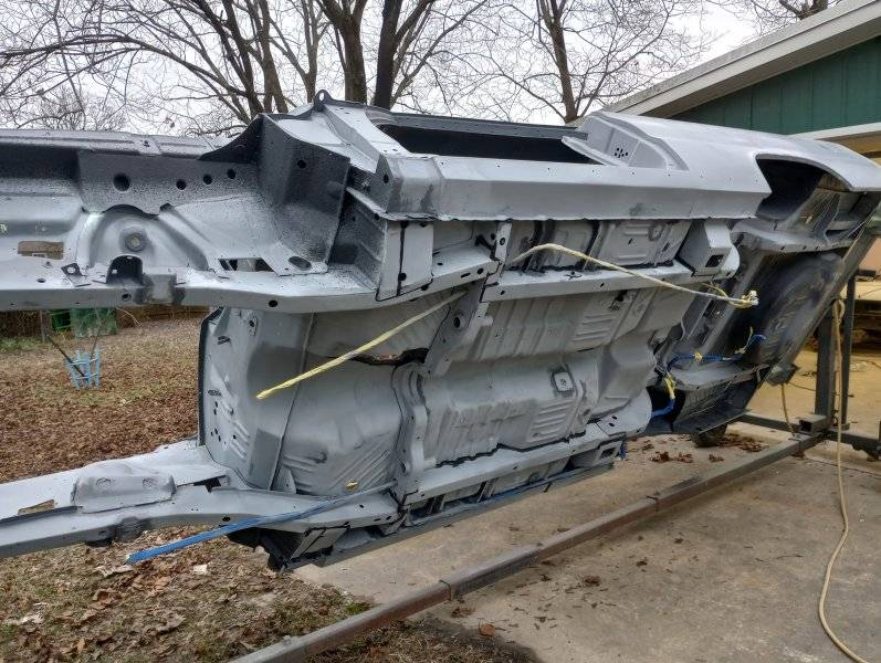

On the last car I did and added USCT stuff, I called and talked to, I think, the owner. What was interesting is he said they had done extensive testing on body flex before and after installing their products on a B body. Frame connectors and torque boxes made the biggest difference, inner fender braces made a little difference, radiator support not much at all. One thing that he told me that did also help tremendously was to weld solid the lower firewall to front floor pan joint, and I followed his advice on that.
