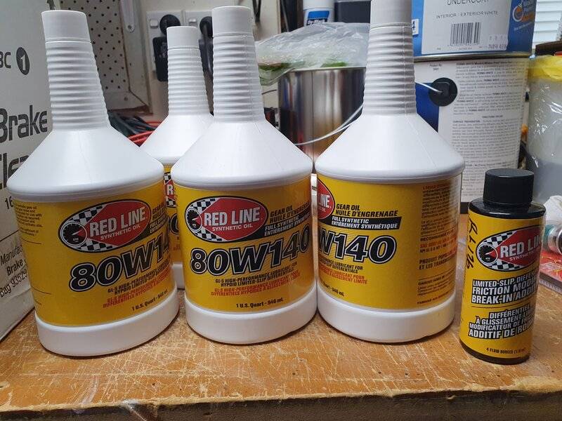

Picked up 4 x quarts of Redline yesterday for my new build ...plus a little extra booster if requiredAre we still talking about diff oil here?
I'm heading out tomorrow to collect some Redline oil with friction modifier built in.

That diff must be huge!Picked up 4 x quarts of Redline yesterday for my new build ...plus a little extra booster if required

I wanted the gallon pack because it's cheaper....but also not available....so I have some spare now.That diff must be huge!

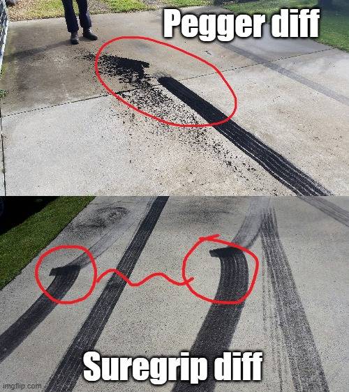

Here ya go...I made it easy for future reference to all here....Simply do a burnout.
You'll know.
