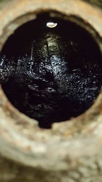

Working on a Chrysler... and now I think the black guck is not fuel residue, but a sealer... and factory at that! It's soaking in lye, but I don't think lye is going to cut it. Now I'm thinking acetone or alcohol.
Inside my old tank. Looks like varnish and probably lead deposits. Bought a new one. Seam was leaking too.
