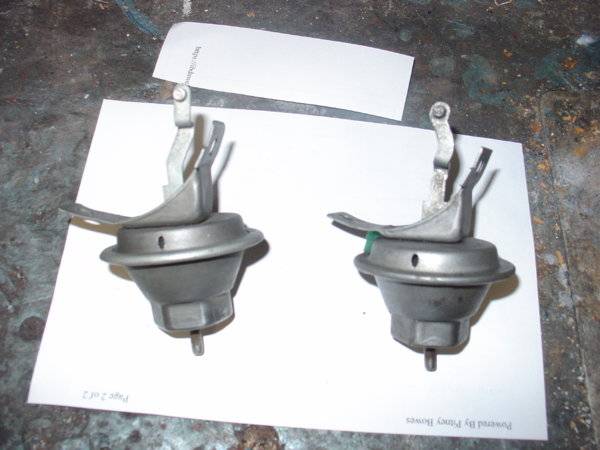

well I remember have read clearly LBS and not X on the arms I have had in hands... If I find some will post
( editing... or it was just L ? )

Awesome! Thats what I thought. There is also an L or R on some of them to tell which way they mount in the distributor depending on its rotation I believe .
Yes, the L & R is for the rotation of the distributor. One is used for small blocks and the other big blocks.
got it!!!! so I was wrong then!!! thanks!!! new stuff to learn!
mine is Big block so I guess L is the correct and that's why I allways see the L on the replacements
Just FYI on the b/rb advances there are two different shaped arms make sure you order the one you need, and no they can be points or elect.

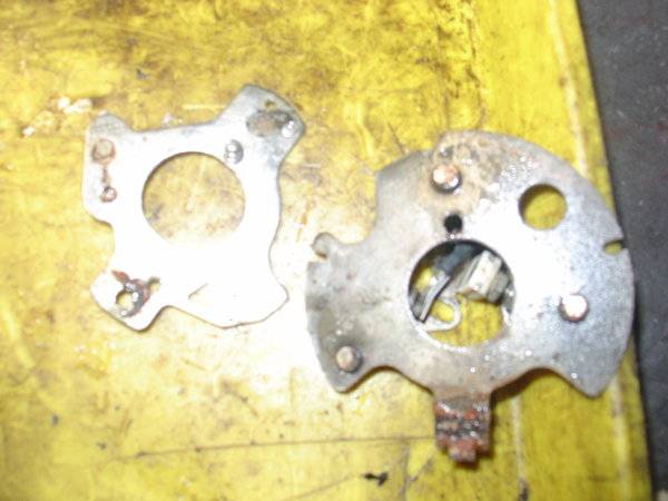

@Billccm traded me a vacuum pump for my coolant pressure tester. Bottom line is the Pertronix III cheap cheesy mechanical design has worn in just a few weeks of driving such that the plate that the vacuum advance pulls is loose and floppy allowing some of the normal pull action to be translated into a rocking movement in the plate and not rotational. Trying to think of a way to get the parts clamped together better at the pivot point and remove the slop in a long lasting way. I am thinking of another job for Shapeways and 3D Printing. It is a simple piece I think I can make to snap in and glue to make the unit way more robust.

The triangle clip worn out on the bottom of the plate? They do crack and lose tension.

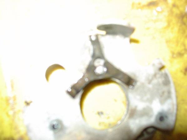

Yea that plastic "bushing" that is mounted to the upper plate (by melting 3 pins) then has the 3 small clips that clip into the lower plate. They are worn and allow the upper to rock on the lower already.
I am lost thinking the bushing that goes under the cam plate got a pic by chance? I rebuild them and never saw 3 small clips .
If you need a plate I have a bunch just need a pic of what you have now.
