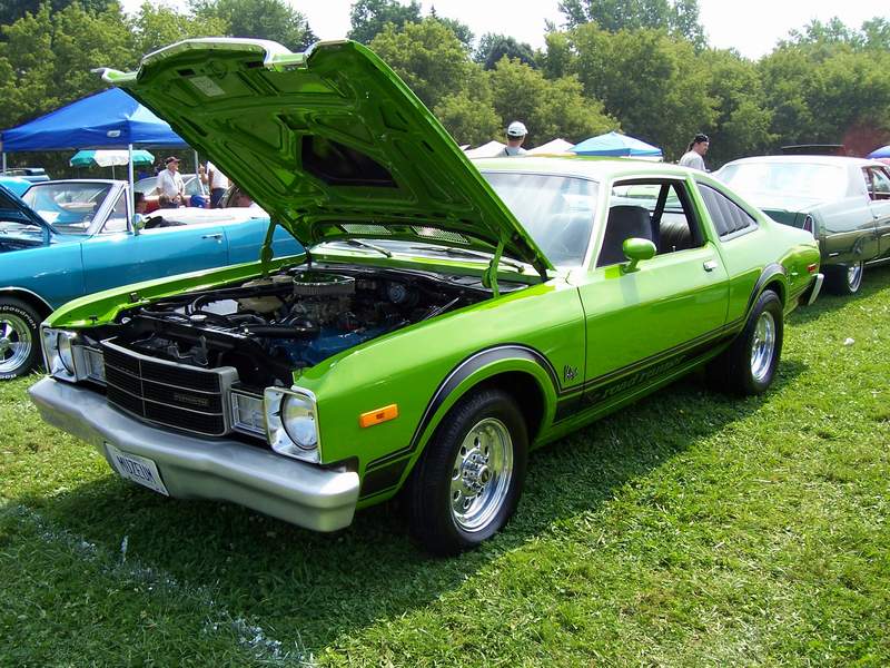

I had a 600 Holley double pumper on this 318 engine in this car.
1971 318 engine with a 340 cam and headers that's it.
4 speed with 3:23's out back.
I had a vacuum secondary Holley 600 on it prior to changing to the double pumper.
Night and day difference.
