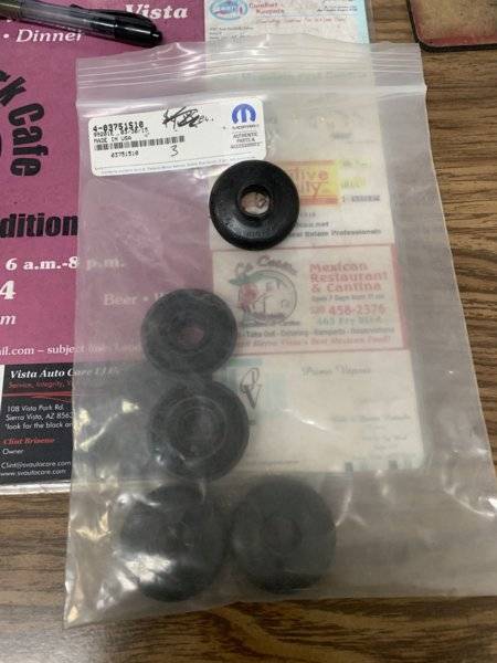

Shop can’t source the large grommet. Got the POV one. Where can these fittings be found. Reported to be 1970 vintage.

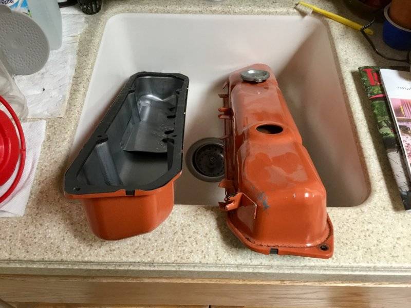

Off topic, shop says they are warped. I laid them on the floor and they seems pretty straight, nothing torquing them down a bit wouldn’t cure. Any opinions?
If any of the bolt holes is dented in I lay the VC edge across the jaws of my bench vise and tap them back to flat with a small hammer.
Mike
You'd want them to be as plumb/true as can be before you approach the head with 'em, Dennis.
I've had luck using my gunsmith type small brass hammer (one end is plastic, the other brass)
and holding them against the bench vise, then laying a straight edge on them to eyeball.

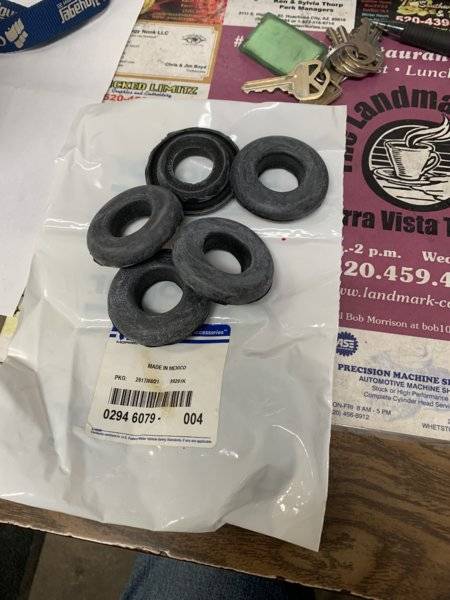

OEM Original at your local Dodge dealer...
PVC: 3751510
Breather: 2946079
