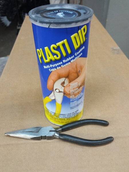

I used Plasti-dip and applied several coats with a small solder resin brush and built it up until I got the thickness I wanted.
Plasti-dip. I sometimes find it’s too thick. So I take some out in a separate small container and thin with a few drops of acetone. Then do multiple dips until it is thickness you want…or thick enough so that the wires will get slightly nipped.
I restore and customize parts for a living, and add yet another vote for PlastiDip. CaswellPlating.com has it for a good price and ships quickly since I can't find it locally out here in the boonies.
