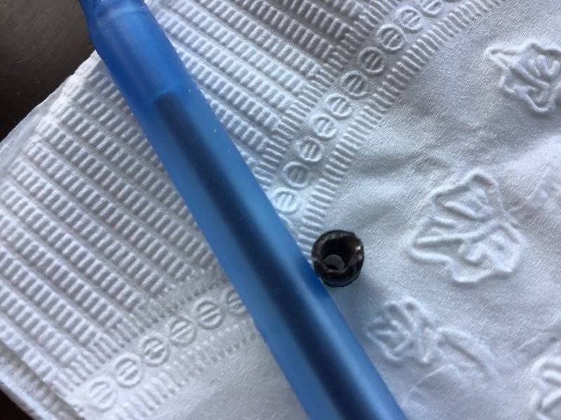

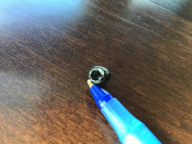

Here is a small bolt I just removed. That’s a BIC ball point pen in the photo.
